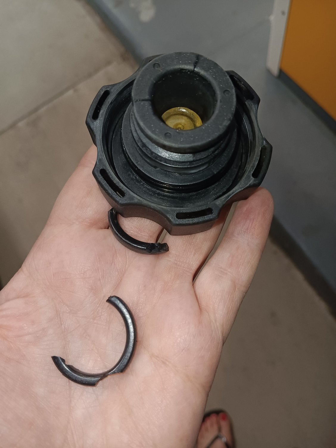

That was the 1st thing we did -all good. New rad gets here Saturday. Took the rad cap off last night to only to have the o-ring come off in pieces. So between the plastic tank leak & a bad cap, I think the problem is pegged. I'll report back this weekend once the rad is replaced.

The cooling system relies on keeping the coolant under pressure. So, any leak in the system, from the cap or the crack in the radiator, will allow it to overheat.
