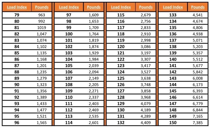

The tire load index is the amount of weight a single tire can safely support at max air pressure. Example: a load index of 116, can support 2,756 pounds at maximum air pressure. Multiply that by four tires (4 x 2,756 = 11,024 pounds) to get your H3s maximum load carrying capacity. Also, never install tires with a lower load carrying capacity than the original tires that were factory installed on your vehicle.

Load index is based on MAX TIRE PRESSURE, which is @ 44psi for the MT tires posted above. Recommended to get tires with a load index that will support GVWR on 2 tires able to hold the load shift weight when cornering.
Chart below shows how air pressure affects load index:
