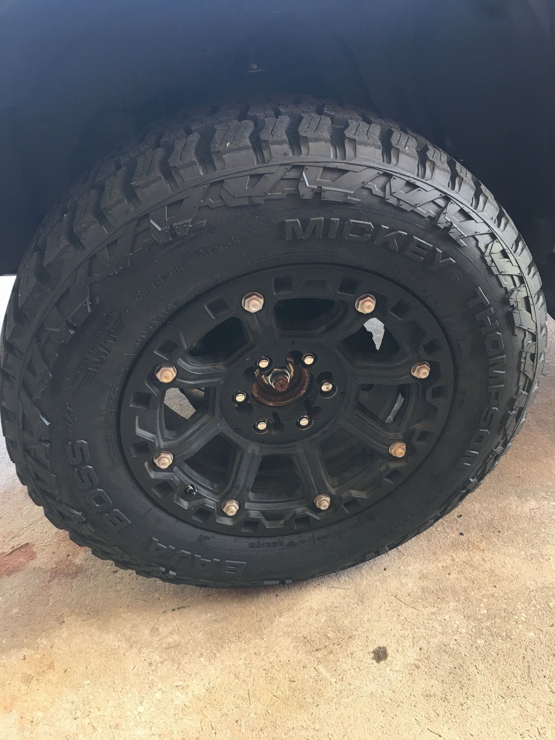

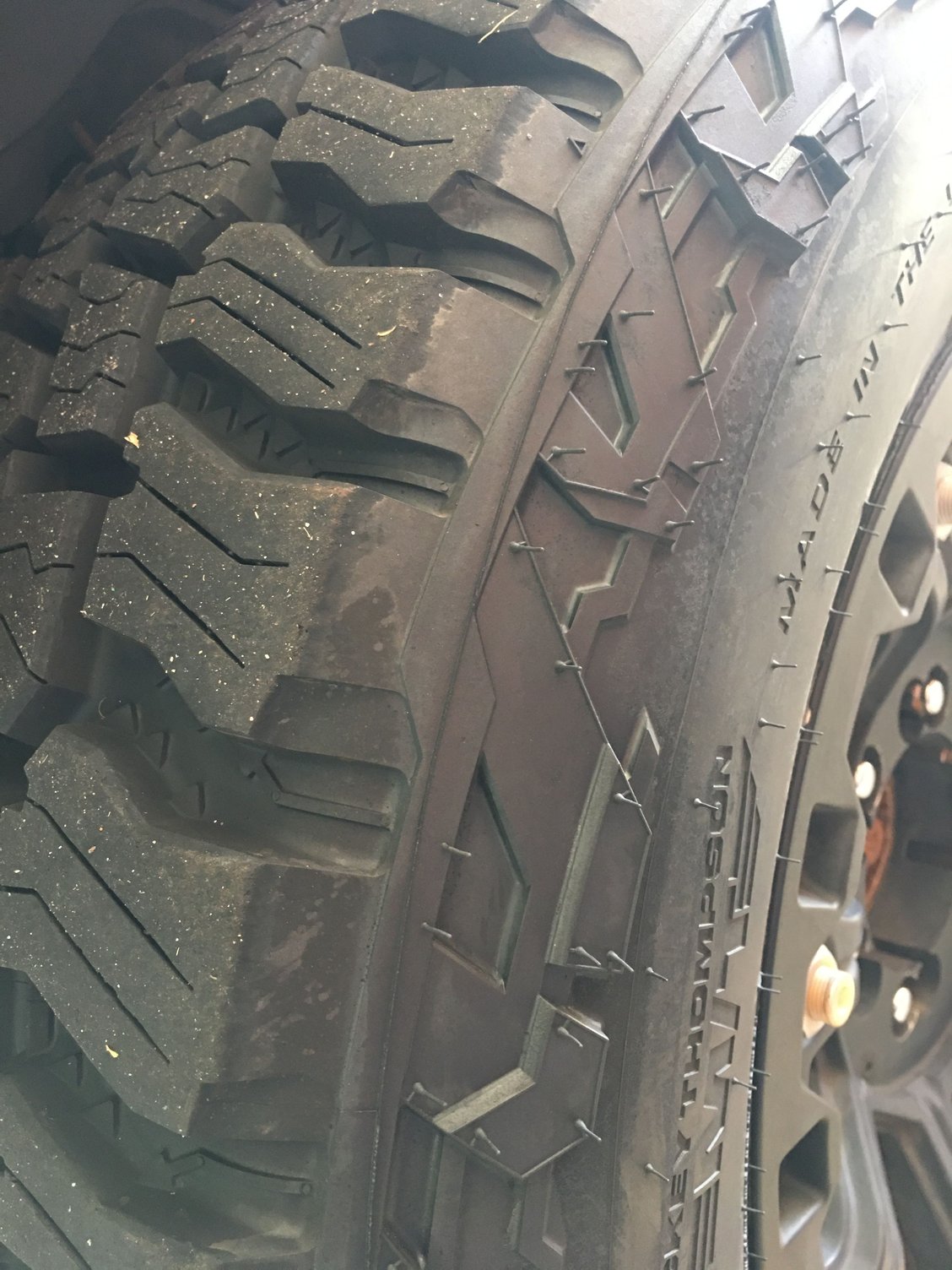

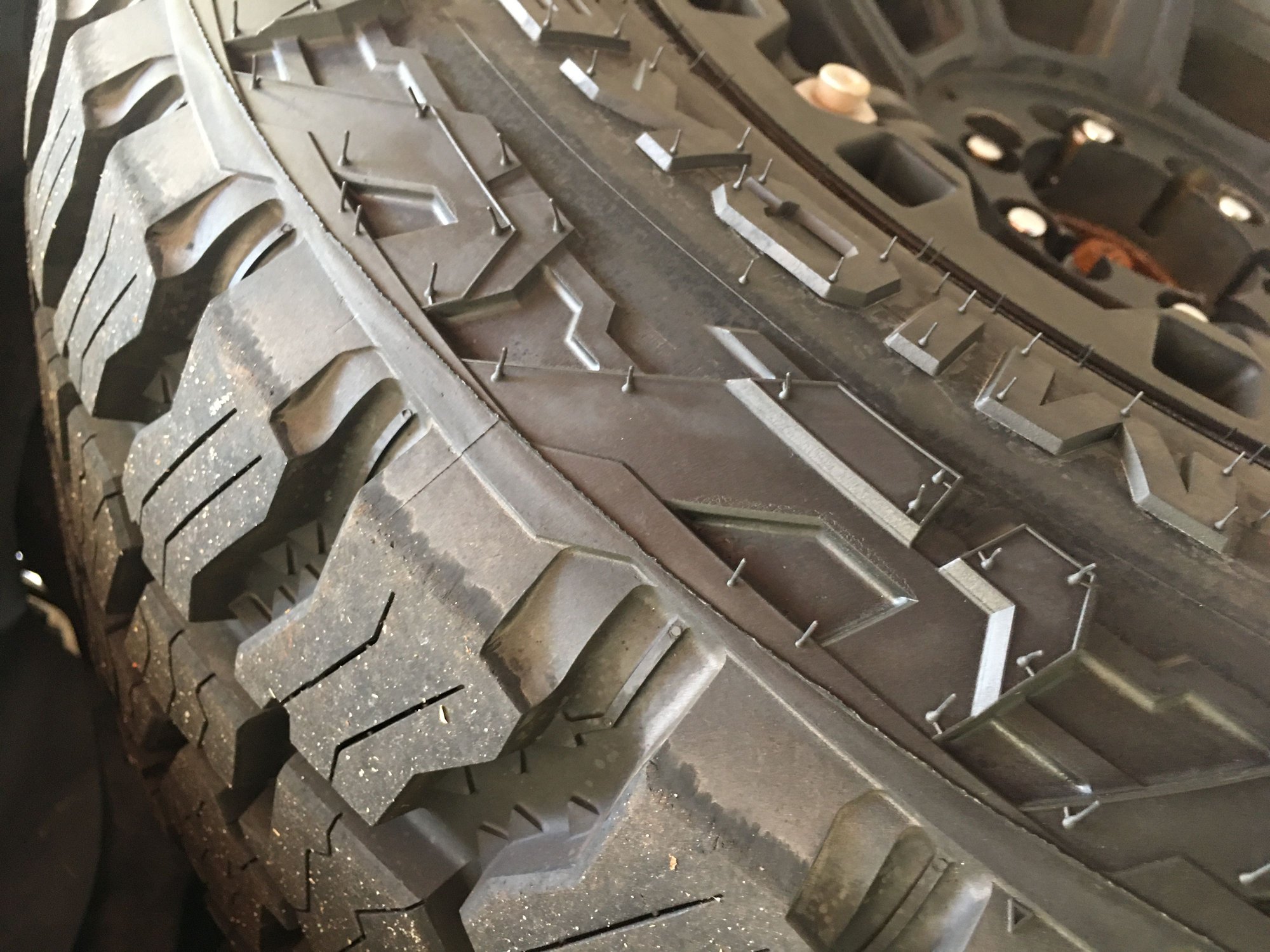

Was down with covid for 2 weeks so I’m back OK I got the tires love them but it seems like the wearing on the outside I’ve tried the chalk test didn’t really notice anything it seems to be wearing bad on the driver side outside the passenger side don’t look that bad what’s the issue less then 500 miles on em
Old Sep 5, 2024 | 01:49 PM
Get your front alignment checked. If you adjusted T Bars, that is a must do after the adjustment. It's worth the few bucks to get the most out of your new tires.
