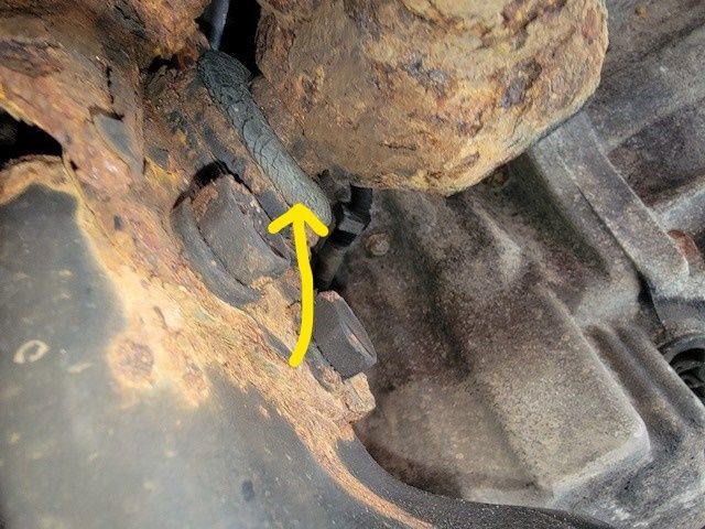

Greetings. This is my first post. Great site. I recently just had a lot of work done on my 2007 H3. I am friendly with my mechanic and he mentioned that I should really replace the torsion bar (which he can get); but the bushings are nowhere to be found.
He checked GM and a couple aftermarket places. I have attached a couple of pics what I am looking for. I drew yellow arrows of the part needed.
Does anyone know where to find these? Thank you for any help.
No such thing

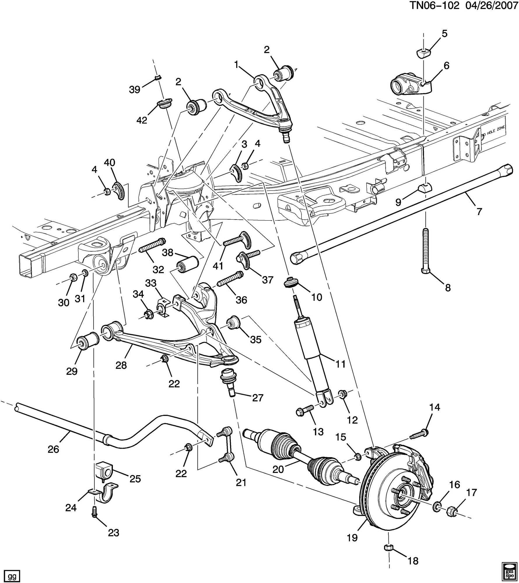

maybe whats circled in the picture is #38?

Bronxteck, do you think it might be this part: https://www.suspension.com/moog-k200155

Hummerz, do you have the list of the numbered items on the diagram? Or know where it is located? Thanks for any help.
Old Dec 14, 2022 | 08:26 AM
Posts: 9,018
Front Lower Suspension Control Arm Bushing - GM (15088366)
N1 SUSPENSION/FRONT
HUMMER > 2007 > H3 > 3.7L L5 > Suspension > Control Arm Bushing

If your mechanic is telling you to replace the Torsion Bars, maybe you need a different mechanic. Very little reason to do so unless your H3 has very high mileage or you have a winch bumper for a long while..... and what you were talking about is a Control Arm Bushing???????
You can adjust T Bars if the OEM front end is drooping.
Old Dec 14, 2022 | 10:15 AM
Mark Eaton's Avatar
Joined: Dec 2022
Posts: 5
Doc Olds... yes, he did say he wanted to replace the torsion bar. My H3 is a 2007 with only 147,000 miles. All highway miles and no winch. It is in actually good shape, but some undercarriage rust.
I will talk with him about that. Thanks for the tip.
Not if they are connected to bushings, the bushings would spin.
