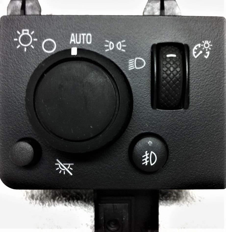

Not the alternator, The GM regulated voltage control system(GBCM) can vary from 11.5 –15.5 volts.
Notice any difference when you rotate the HL switch?

i am using stock terminals but they are clean. I also check the HL switch and no difference. Also If the engine is not running the lights don't pulse.
