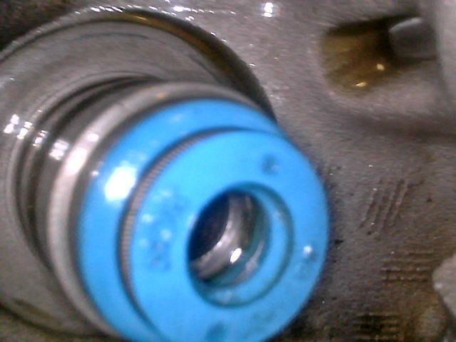

Was running good, not sure exactly why this happened but am assuming a weak valve spring. Valve spring broke twisted down, cap popped off with keepers and dropped the valve right into the cylinder on the highway and that was the end of her. This was the reman cylinder head from express. Sooo... I dunno 😕 lol picked up a complete low km engine from a colorado sitting at the wrecker yard. Almost had enough of this thats foresure.
