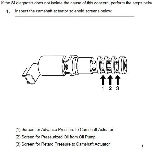

>>>>>>LOOK HERE:::::>>READ the 7 tsb's included:::>>>HUMMER DTC P0017
Subject: Belt Noise Rough Idle and/or SES Light with DTC P0014 and/or P0017 - Inspect CMP Actuator Solenoid
And Crankshaft End Play
Models: 2004-2009 Chevrolet TrailBlazer
2004-2012 Chevrolet Colorado
2004-2011 GMC Envoy
2004-2012 GMC Canyon
2004-2009 Hummer H3
with an Inline 4, 5, or 6 Cylinder Engine
(RPO Codes L52, LK5 LL8 LLR LLV)
This PI was superseded to update Models. Please discard PIP3694E.
The following diagnosis might be helpful if the vehicle exhibits the symptom(s) described in this PI.
Condition/Concern
Some customers may complain of an engine belt noise, rough idle, and/or SES light with DTC P0014 and/or P0017. If a rough idle is experienced, a P0106 may
also be stored.
Recommendation/Instructions
If the SI diagnosis does not isolate the cause of this concern, perform the steps below:
1. Inspect the camshaft actuator solenoid screens below:
(1) Screen for Advance Pressure to Camshaft Actuator
1(2) Screen for Pressurized Oil from Oil Pump
(3) Screen for Retard Pressure to Camshaft Actuator
If any of these screens are missing, replace the camshaft actuator solenoid, change the engine oil and filter, and re-evaluate the concern. If none of the
screens are missing, proceed to step 2 below.

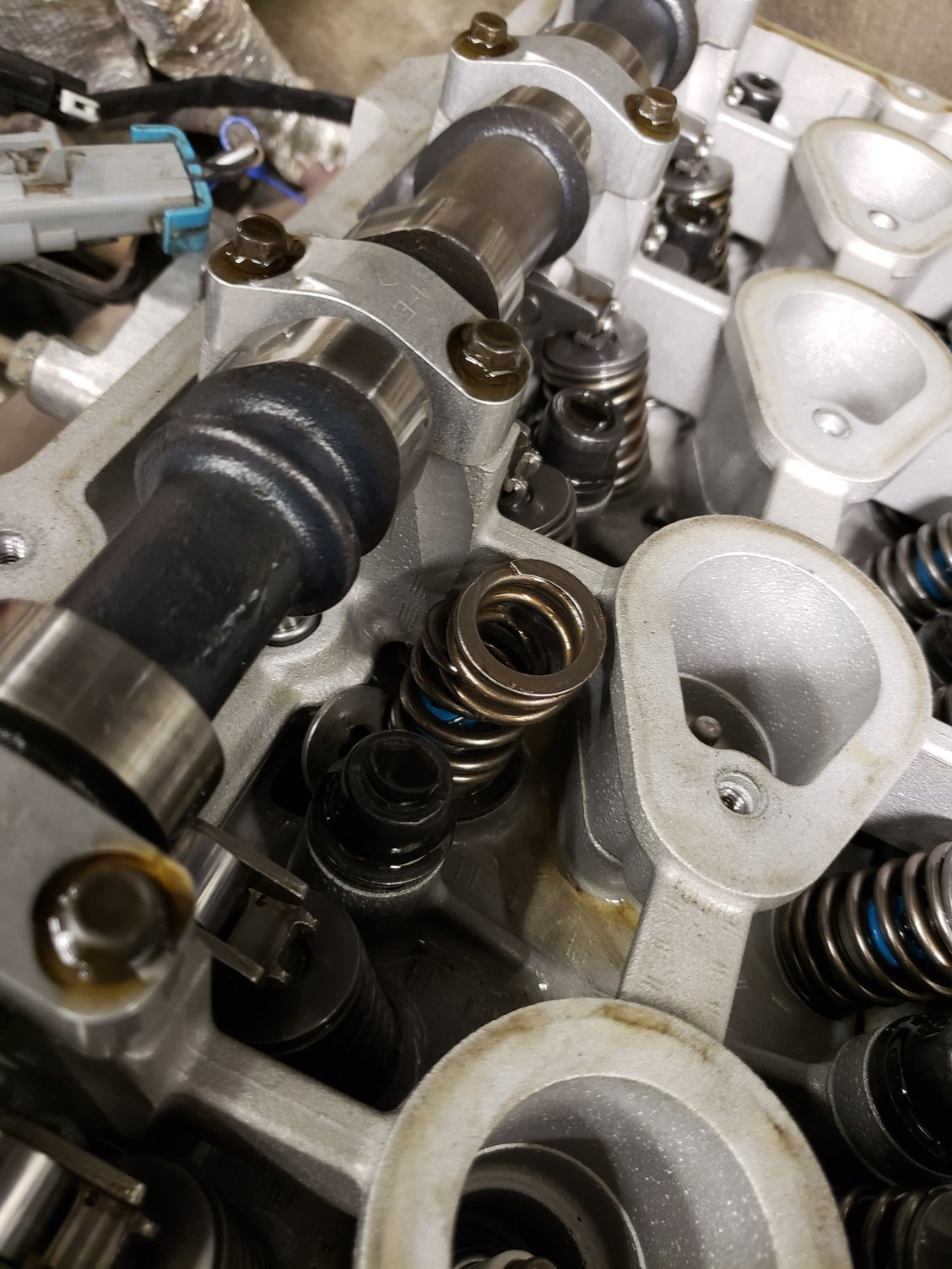

Default Soooooo this happened
SOAB
Old Apr 26, 2022 | 10:26 AM
  #70
Posts: 3,213
now what... wasn't that a new head? did the seat drop out?
