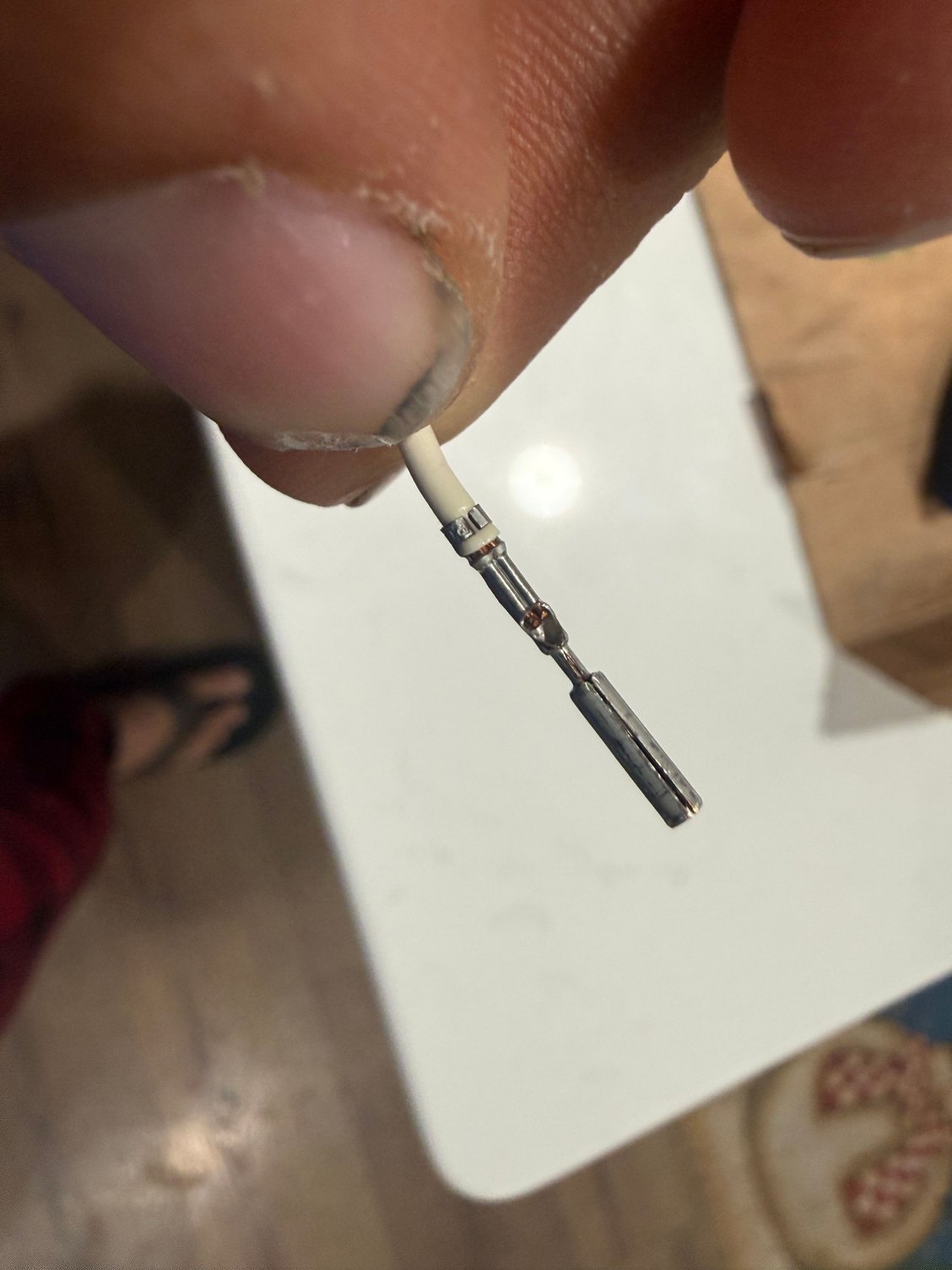

Does anyone know what 2007 hummer h3 use for their pins? I am trying to repin the bcm connector becuase they all got missed up. There are a lot of models . I ordered 12084912 but it wasn’t the right length and figment . Any ideas ?

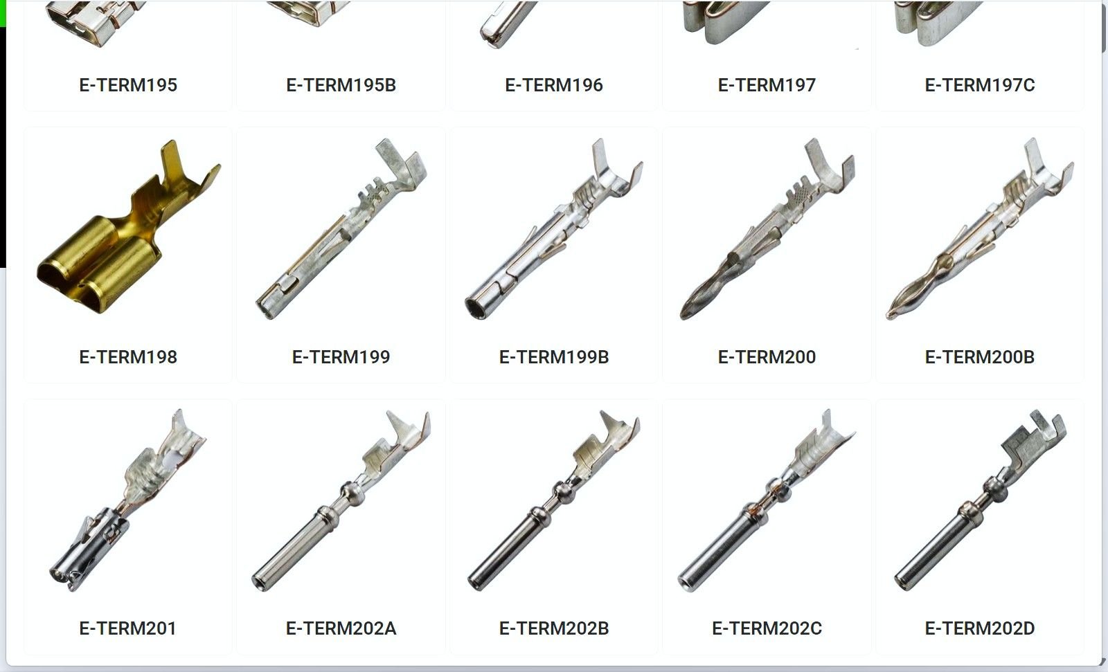

LOOK HERE OR CALL 1-866-300-0708>>>> Connector Experts TERMINALS

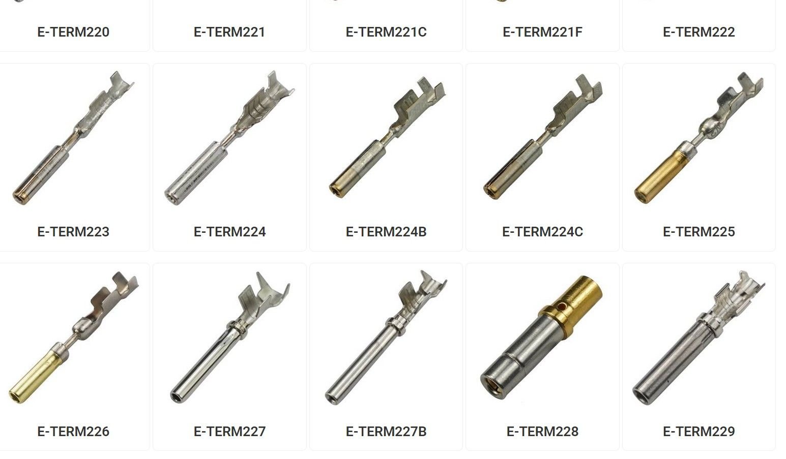

Thank you I contacted them and they were able to find it it’s model E-Term224
they are 30 bucks a pack of 10. Little expensive but it will get the job done. Thank you

There are multiple versions of the 224- different diameter or made from different metals?
Just be sure to check they fit to the pins with some resistance snug fit not loose.

I contacted them and sent them pics of the pin and the connector and they said it’s just regular 224 so let’s hope the are right
