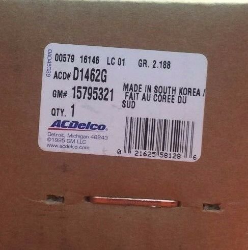

Thank you for reply. I will do like you said. Can you recommend a website where I can buy the ignition switch sensor only? Im looking for it but looks like they doesnt sell it separately. Im not from USA but my friend is in right now so he can bring the part with him when he come back.
Appreciate for any help.

Old Jun 25, 2021 | 09:05 AM

thank you hummerz :-)
