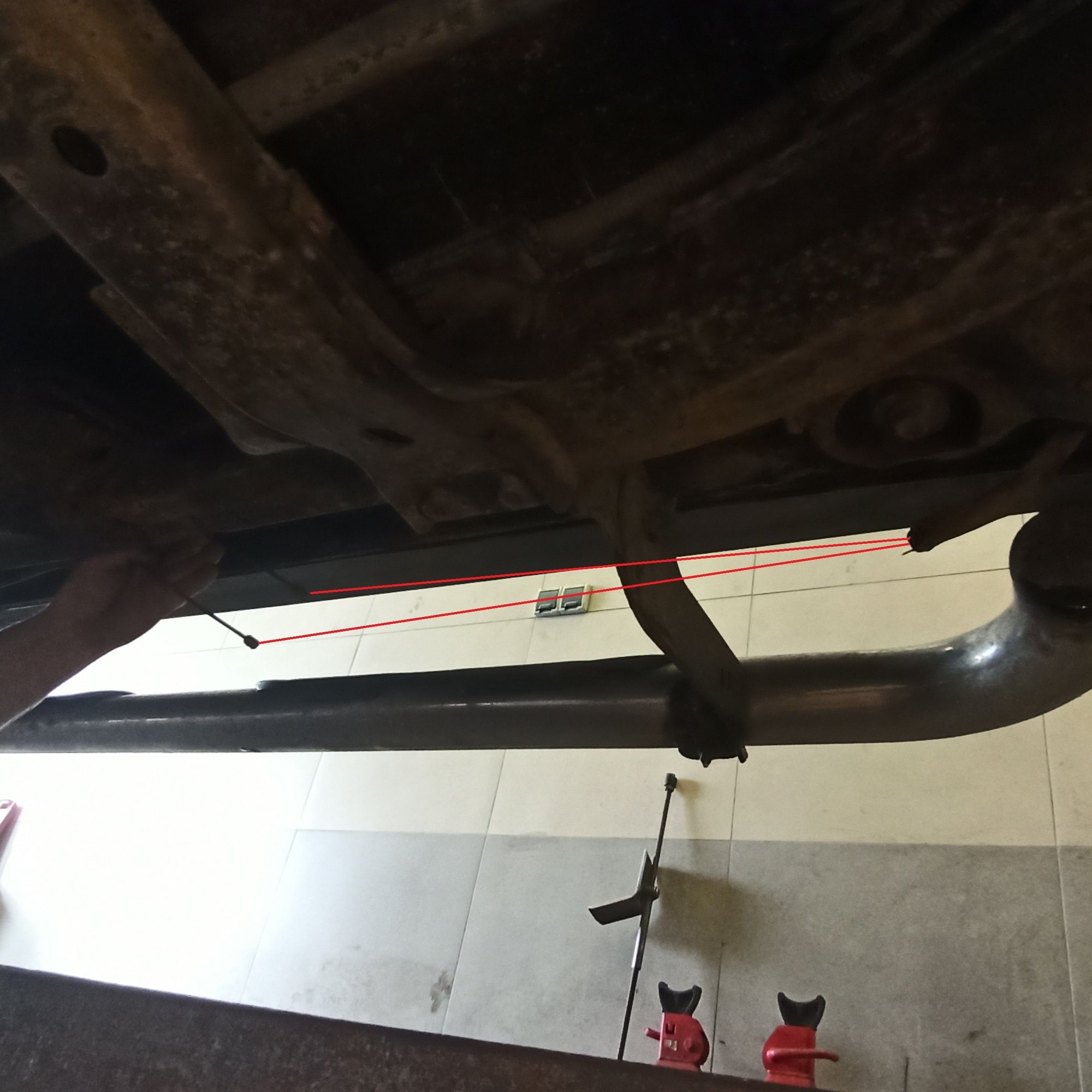

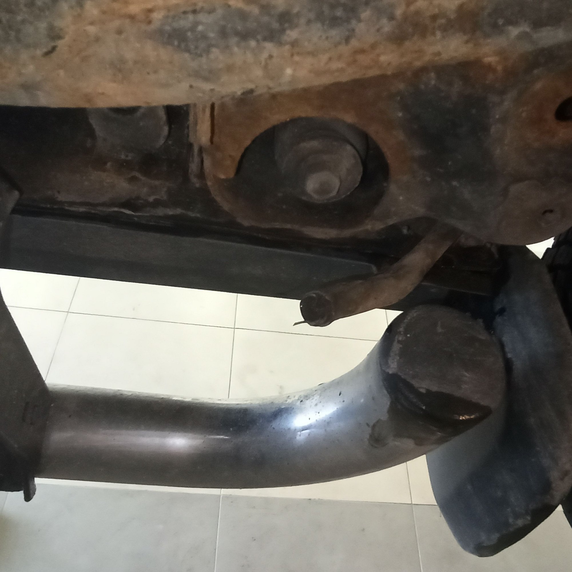

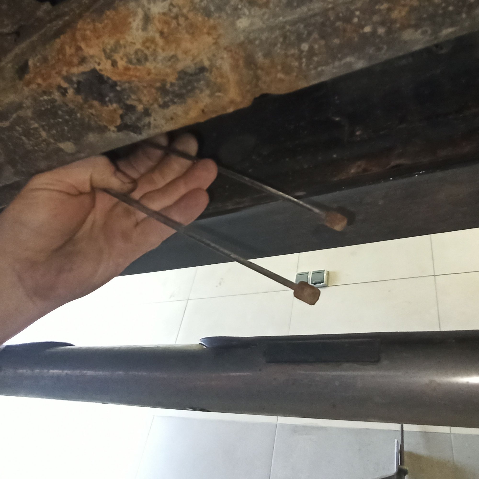

Hello friends.
Im confused about what part number of parking brake cable Im looking for.
Let me show you what Im looking for and what I have found.
Take a look at pictures first.
Is this part number GM 24301032 ?
If so, where can I buy it? I have found some websites but there is an info that part is discontinued.
Can you help to find the right part to my car?
Here I draw red line which parts I have to connect by that cable.
I found it on youtube. Thats exactly the thing Im looking for.

Looks like the front cable is part of the parking brake pedal assembly. GM 20832044
the part that joins the front cable to rear cables is the equalizer. GM
20913272
I couldn’t find something that clearly shows the equalizer nut. Maybe GM 11571172

Today mechanic installed all parts and all fit as it should.
Thank you very much for your help. Those were the one I was looking for
Best regards :-)
