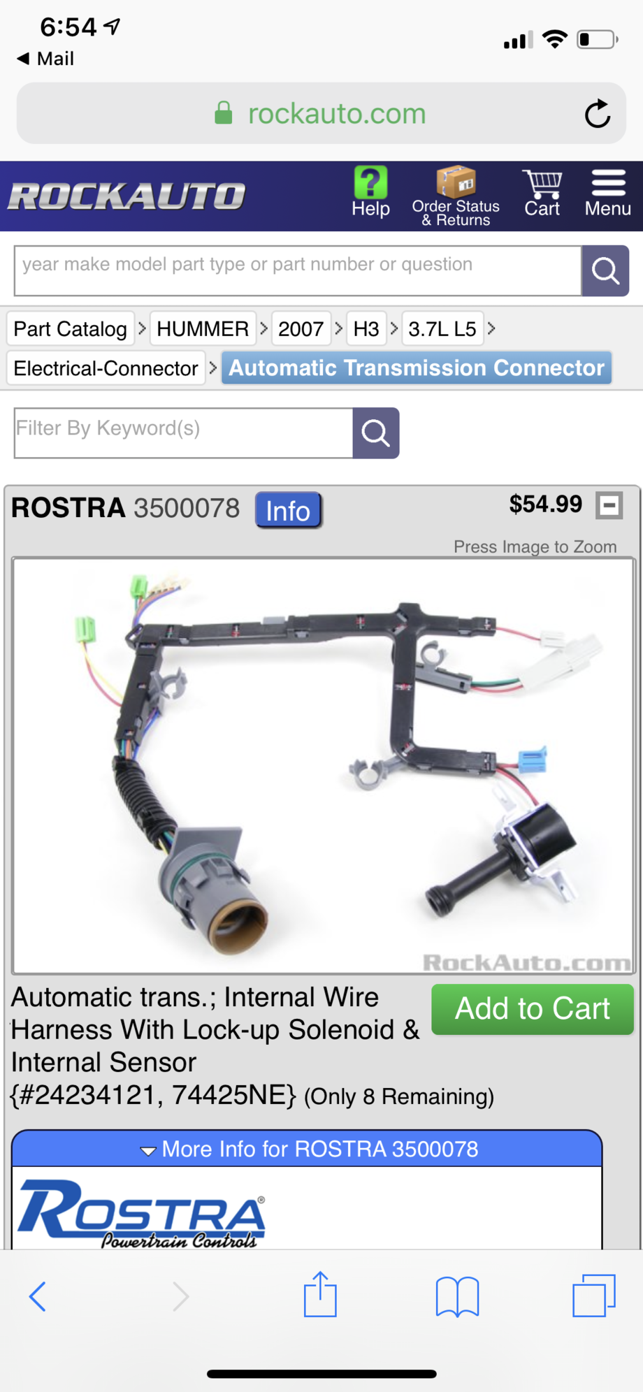

it might be better to just repair the one you have properly.
The shop said the pinch is too deep not recommended to repair but I just want to know is it that rostra wire harness that they are talking about ?

google the part number you posted. there are a bunch of online gm parts distributors that are selling it much cheaper then $230. GMwholesale has it listed for $141.83

Yes i I saw that but they don’t have a pic. I found transmission harness for 57 bucks aftermarket that have just like the pic hummerz posted. Everyone who have it cheaper for 137 or 141 is out of stock because it’s on back order

Any tech with proper knowledge knows you can repair a wiring harness. I would pull the pins on each end of the damaged wire, and install a new wire with new pins.
Call for more information on a replacement harness(note you have a 20pin connector):
https://globaltransmissionparts.com/...-iss-24234121/

He wont replace it but I found one that is 57 bucks it’s cheaper to replace than repair . But that’s how the wire harness look like and found it way cheaper , can I replace that my self or does it require special tool or way? Also they mentioned they have to relearn it?

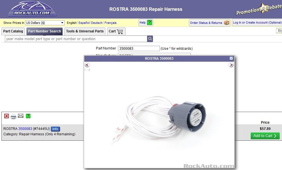

You have a 20pin connector(you posted a picture above), the "57bucks" is a 13pin.. Call the number I posted above and make sure you get the proper connector or it's useless.
Old Aug 2, 2019 | 05:04 PM
  #28
NFS's Avatar
NFS
Joined: May 2016
Posts: 739
Yes thank you , I got one from rockauto that is it for the 07 hummer h3 that have 20 pin connector I believe cus they said that fit for the 07 but ill
dpuble check
Old Aug 2, 2019 | 05:47 PM
  #29
Posts: 9,024
dpuble check
That is only an external repair connector!
Old Aug 2, 2019 | 05:55 PM
  #30
NFS's Avatar
NFS
Joined: May 2016
Posts: 739
That is only a repair connector!
Lol no here I attached a pic of the item
