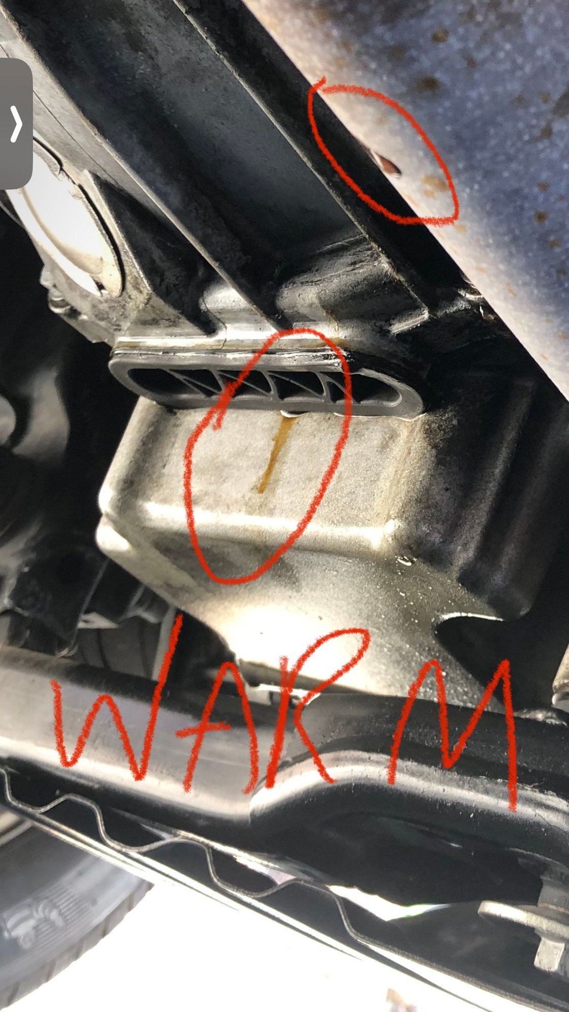

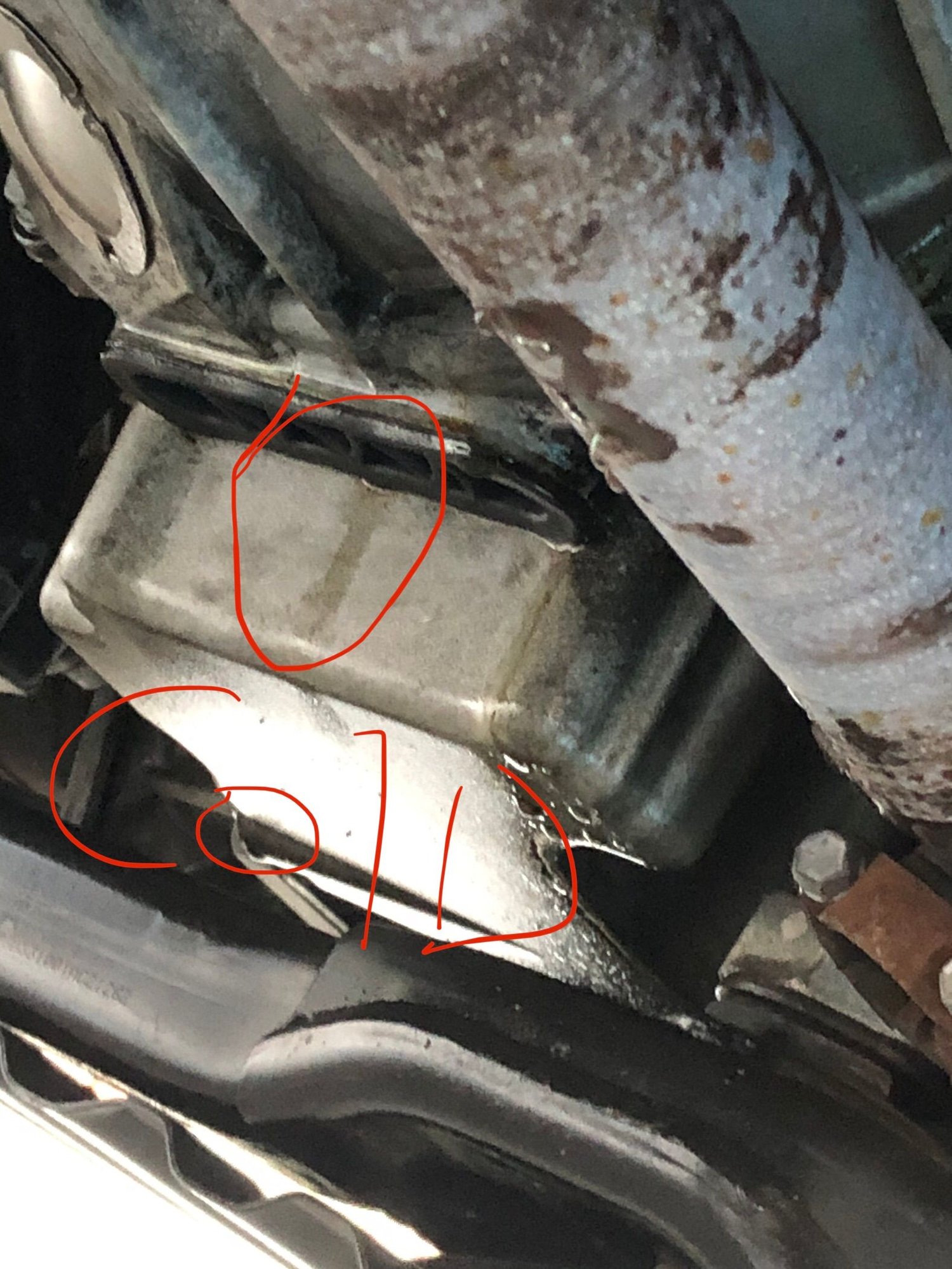

UPDATE:Just let in run for 10 min in the driveway. Cold engine and no drips of any kind (see pic) , after 10 min, warm engine oil oozing from pan (see pic) and milkshake on oil dipstick and under fill cap.
headgasket was replaced 50-ish miles ago.

Who replaced the head gasket?
the same guy who’s been working on it from the start. Shade tree but that’s all he does so his shop is his house. I’m beginning to think he put the gasket on upside down. But that oil leak in the above pics.. yikes! What’s going on w this thing? Do I need t take it elsewhere or will the milkshake be a definite diagnosis?

Posts: 9,018
DO NOT run engine, repair the coolant leak, drain/refill engine oil, prevent Spun Bearings
