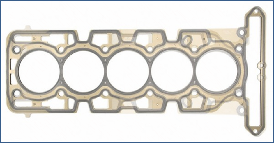

I guess it is possible to put the head gasket on wrong but you would really have to be trying to get it wrong. or completely oblivious to common sense.
^^^ That. Here you can see what the gasket looks like (overlaid on original) when put on upside down. Most everything still lines up the same except a couple of areas that a ham-fisted/oblivious mechanic could "make fit" if they tried hard enough.
