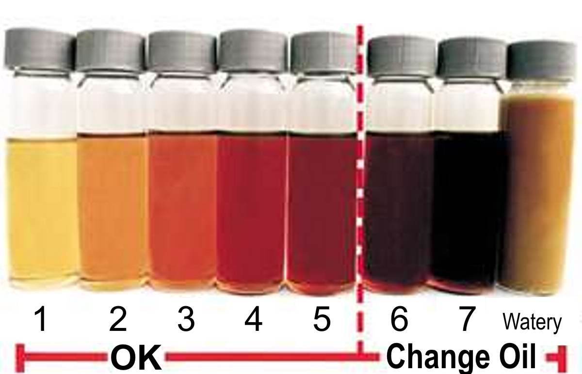

Your OPS as failed. Clean the connector all you want and the OPS will still leak!
You need to change the OPS, flush the engine, and refill with a quality, FULL synthetic oil.
Then monitor the color, and change the oil again:
