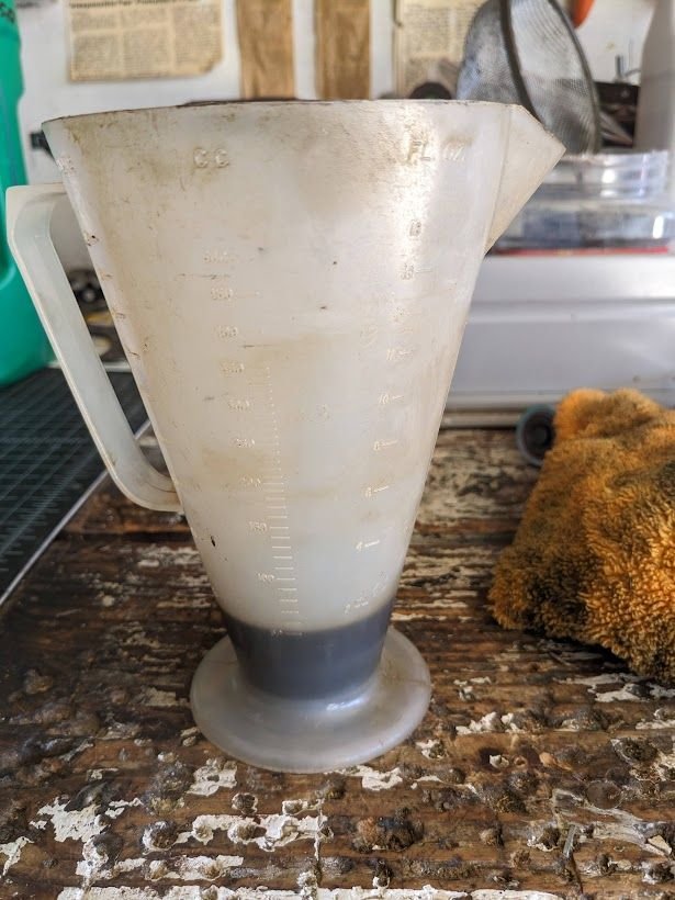

So, funny thing. I was changing my oil today (using my Fumoto valve), and decided to take you up on your challenge. So first I drained my oil using the valve:
I then removed the Fumoto valve and caught the additional oil that drained out into a graduated container. I used a flexible Pig Funnel so as not to lose any of it, and let it drain for another 5 minutes till nothing further was coming out:
Here are the results:
If you look closely, that oil level is at exactly 50cc, which is 1.69oz. So less than 1% of the oil was left in the oil pan after draining using the Fumoto valve. That's a far cry from your claim that using the Fumoto would leave 5% (9.6oz) of the dirty oil still in the bottom of the oil pan. Not that I enjoy proving you wrong, since you have a massive amount of knowledge about these vehicles, but you really should learn to not be quite so arrogant. It's not very pretty.

"around 5%">+/- depends on capacity & level-grade when changing oil.
Seriously? Less than 1% (0.88% to be exact) is NOT "around 5%", nor is it "around 5%>+/-". Adding a +/- doesn't typically refer to an 80% variation ; by no one's definition is 1.69oz "around" 9.6oz. Why is it so difficult to simply respond that you stand corrected?
Regardless of your measurement results, that jap plug still left dirty oil in the pan! Proper engine oil change requires removing ALL old oil and replace with new! Any amount of OLD oil left behind will contaminate the new oil immediately! Simple math:-6qts+6qts=100% new oil change!
