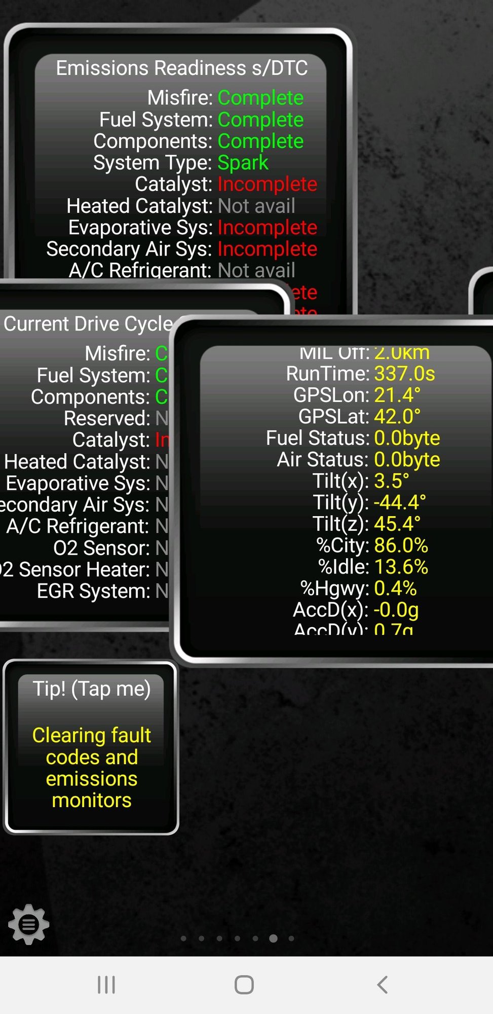

Loss power and boost when reading with elm372 the boost parameter is -9.00 to -11.00 means the car has no boost?
Intake temp 28-32c
Catalyst 400c idle- 700c while driving
Engine temperature euns between 89-96c
Any idea what could affect the power loss and no boost? Some mechanics say that thrrotle needs to re-calibrate
