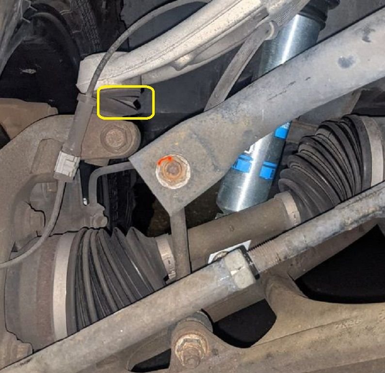

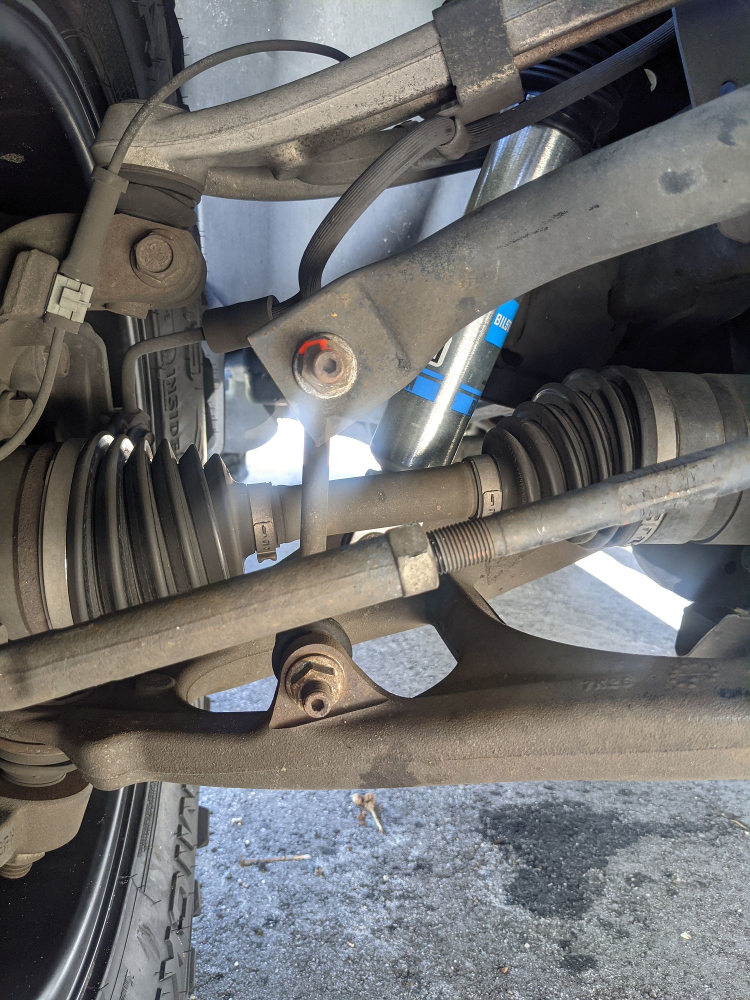

I cranked it down to 24in hub to fender. I believe the sweet spot is 23.75 or so. Is this looking less disastrous? Lol don't worry I was not driving it.

how's that guys?

It's now at 23.7 inch's fender to center hub .

Better.... 23.5 maybe 23.6 is about the max and we could have all told you you do not need any "lift kit" to get there as the OEM Tbars can be adjusted to accomplish that.

Ill remeasure after driving on it and see if it drops a little. I should be in that range.

Do whatever makes you happy as long as you have bank to replace parts frequently. Just make sure to get an alignment when you decide on the ride height, to prevent premature wear on those MT's! My 3 has 91k+ miles @23", and the only thing I replaced on the front steering/suspension/drivetrain was the shocks. All else oe and still tight. Btw, it appears your upper ball joint boot is split.

I thought the same thing at first, Hummerz. But the more I looked, I think it is just the bellows boot pulled open and the dark rings are where the bellows touched when it was lowered. I don't see any of the inside of the ball joints in the pics.

After alignment it settled at 23.5 center hub to fender. I think this post is good because it shows pics of the angles in the front end with the height increases and decreases. I haven't seen a post with this yet so may be helpful for people.
