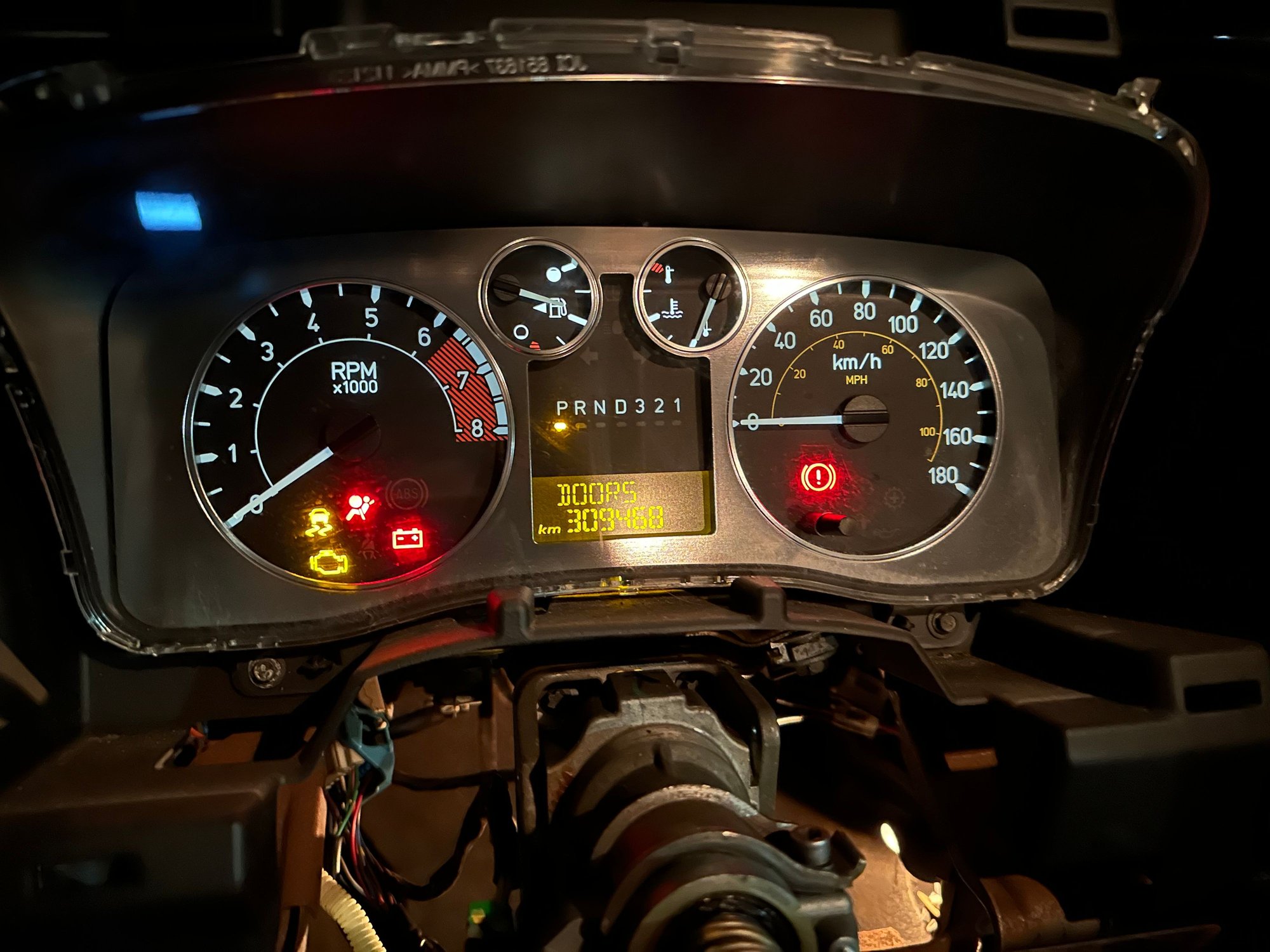

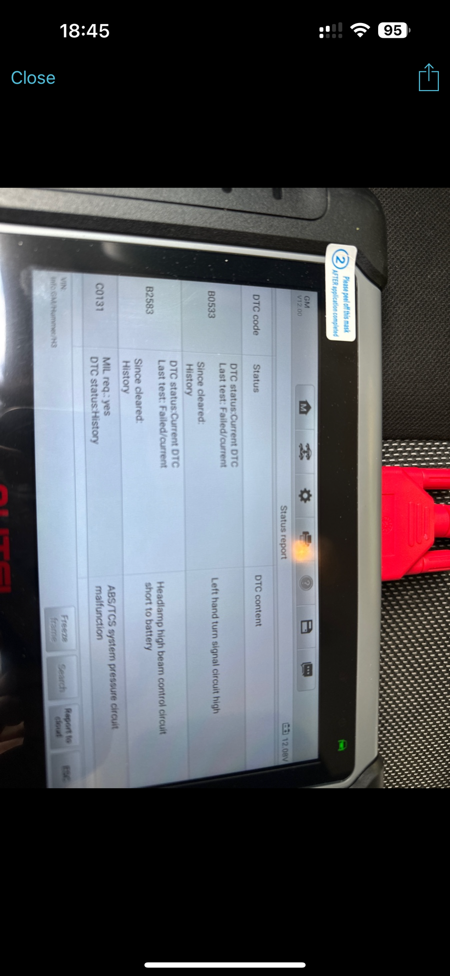

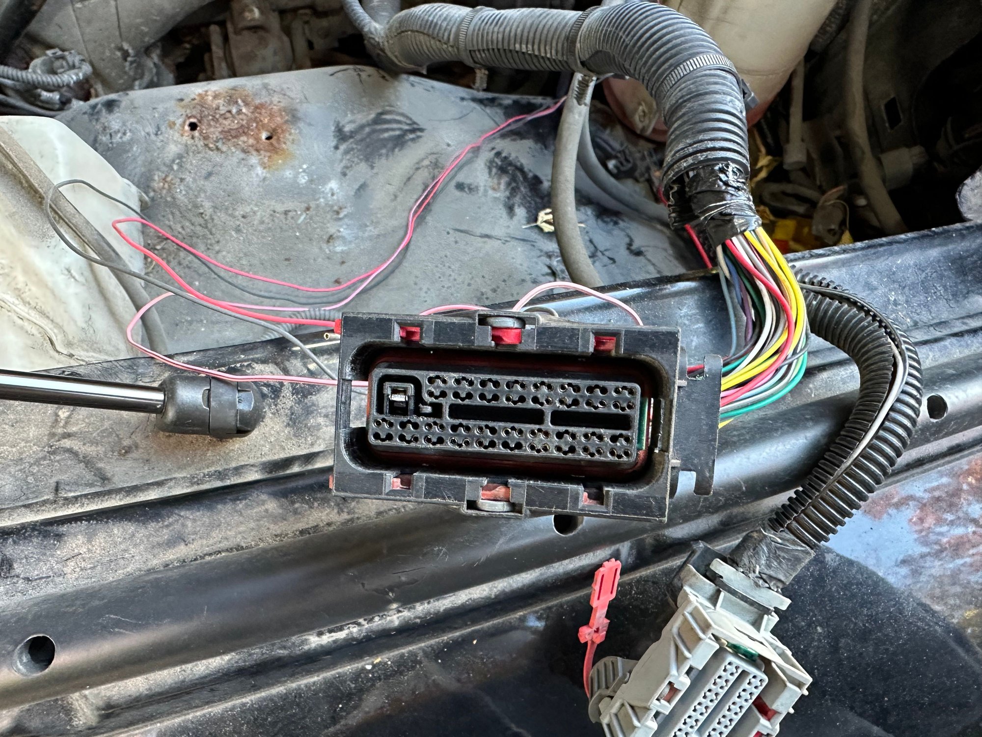

Hi everyone, my 2006 Hummer H3 started fine in August, but the metal fuel pipe under the car leaked due to rust. I replaced the rubber pipe. In June, when I turned the key, there was a crankshaft and fuel pump, but it would not start. I tried the On position for 10 minutes, off for 5 seconds, repeated three times, but it still had passlock. I once replaced a Colorado pcm bcm assembly with the same engine as this car, but it still would not start. I cleaned all the ground wires in the fuse box and engine compartment, but it still would not start. In October, when I turned the key to start, the car made a relay pull-in sound, and then suddenly lost power. It felt like something was shorted out. The vehicle was completely out of power as if it was dead. I had to remove the battery cable and wait for a while before the light came back on. It felt like an overcurrent protection circuit. Does anyone have any suggestions that can help me? I am currently in Toronto. Passlock light sometimes flash.sometimes keep light.
