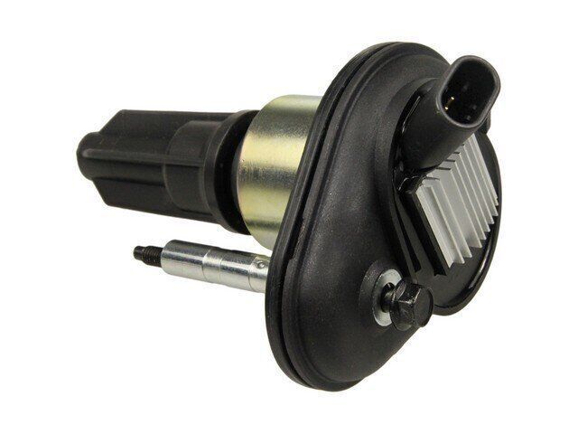

well photo they posted after the fact is indeed coil on plug. i guess they own a H3. would be nice if that was stated on OP

2006 H3 Hummer Ignition Coil On Plug Pack.
This is what the new coils are. Sorry if I didn't say it was a 06 H3
