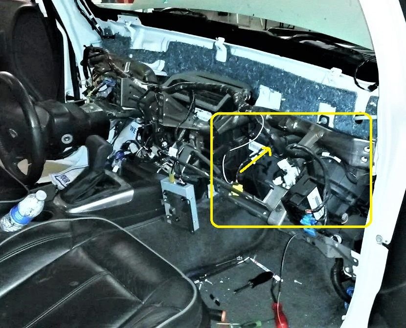

Originally Posted by HeLP
I dont see this when I open the hood
If you can't see that, I suggest you take your H3 to a mechanic...
Old Jun 26, 2022 | 11:29 AM
HeLP's Avatar
Joined: Jun 2022
Posts: 8
let me rephrase. I see that area under the hood. I just don't see where the part is that is being highlighted in the previous photos. Is that behind the fire wall?
Old Jun 26, 2022 | 03:53 PM
Posts: 9,047

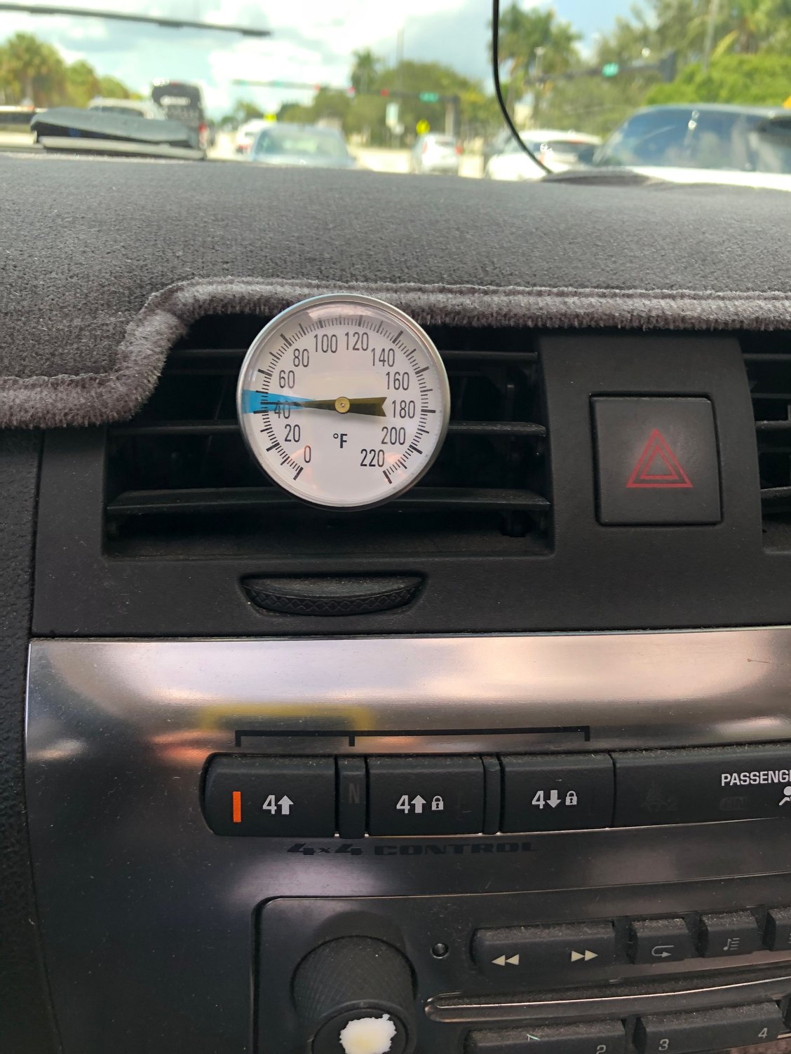

hey guys I have been having trouble with my AC on the06 H3 when its hot outside the ac doesn't blow cold and in the evening it is great, can someone please help me this is driving my insane. thank you
have you checked you clutch fan and condenser for blockage ?
if its daytime, set you fan speed to low and see if the air is cold, if it is, and warm on high, I would install 1-14 oz can of 134a…..do not use a Freon can with a sealer in it, this will clogg your a/c unit and will cost more in the long run…
