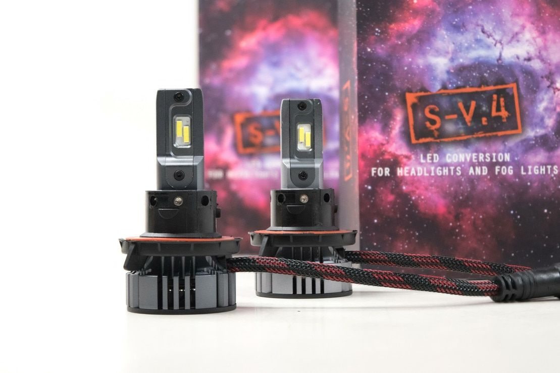

Depends on your budget. Cheap LEDs are cheap for a reason. The OEM buckets are not the best that is for sure, but a high quality LED replacement bulb can make a huge difference.
Any LED swap will require you to re-adjust the beams to not bling oncoming drivers. No LED replacement bulb would be DOT approved when put in the OEM Halogen Headlight bucket. That is the reason when you look them up they say for powersports, fog lights or off road etc... applications and do not say they are for headlights.
I and a few others have upgraded to S-V.4 LED Bulbs. I am happy with those. I did Halogen upgrades before on my old 07 and after burning a few out, moved to Sylvania Halogens when I sold it. Sylvania also makes LED bulbs that fit.
Others have gone the headlight (including reflector) replacement route. That requires disassemble and mods to fit.
The Doctor has spoken. I concur with every thing he said.
LED light output is just not designed for halogen light housings, but quality LED emitters are the way to go, good luck.
