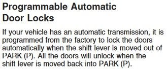

Hello everyone,
Have any of you bypassed the auto lock when you start the car and auto unlock when you shut off the car? If so, can you give me the secret please?
Thank You!!!

Auto lock @Start?

You can program it to unlock all, or just the driver's door, or none when you shift to park. It will always lock all doors when you take it out of park (no choice).
From the owner's manual:
"Automatic Door Locks"
This feature allows you to program the door locks to a
preferred setting.
To set your choice for this feature:
1. With the engine off, turn the key to LOCK/OFF.
Do not remove the key from the ignition.
2. Press and hold the power door lock button until the
DIC display shows the current door lock mode.
3. To view the next available mode, press and hold
the reset stem until the mode appears. Release
the reset stem and press and hold again to view the
next mode.
4. Once the desired mode is shown on the DIC
display, briefly press the reset stem to set your
choice. The DIC display then clears.
The following are the available modes:
Lock 1 (default): On vehicles with an automatic
transmission, this mode locks all of the doors when the
vehicle is shifted out of PARK (P) and unlocks all of
the doors when the vehicle is shifted into PARK (P).
On vehicles with a manual transmission, this mode locks
all of the doors when the vehicle speed is greater
than 15 mph (24 km/h) and unlocks all of the doors
when the key is removed from the ignition.
Lock 2: On vehicles with an automatic transmission,
this mode locks all of the doors when the vehicle
is shifted out of PARK (P) and unlocks the driver’s door
locks all of the doors when the vehicle speed is greater
than 15 mph (24 km/h) and unlocks the driver’s door
Lock 3: On vehicles with an automatic transmission,
is shifted out of PARK (P). The doors will not
automatically unlock.
than 15 mph (24 km/h). The doors will not automatically
unlock."
