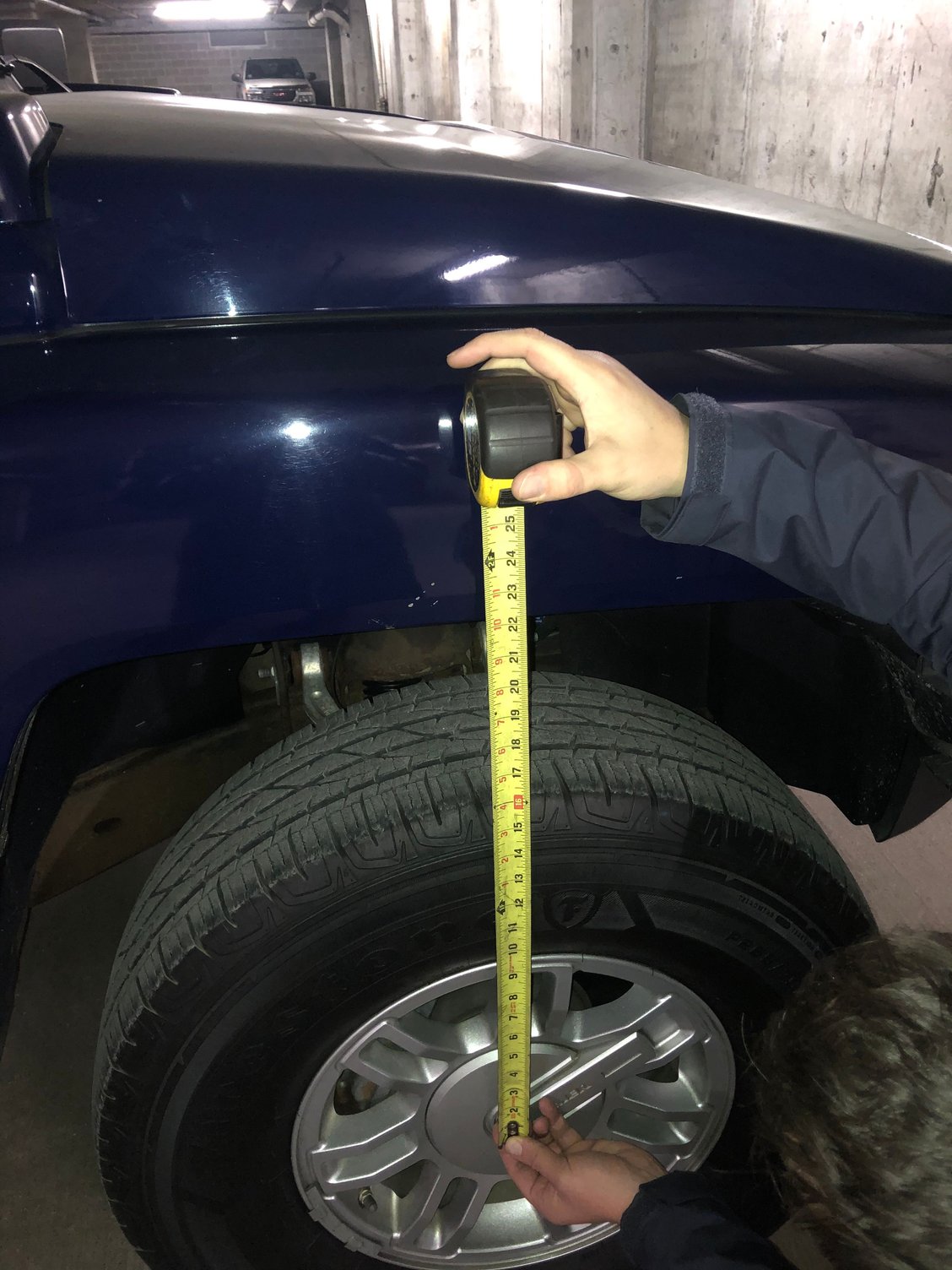

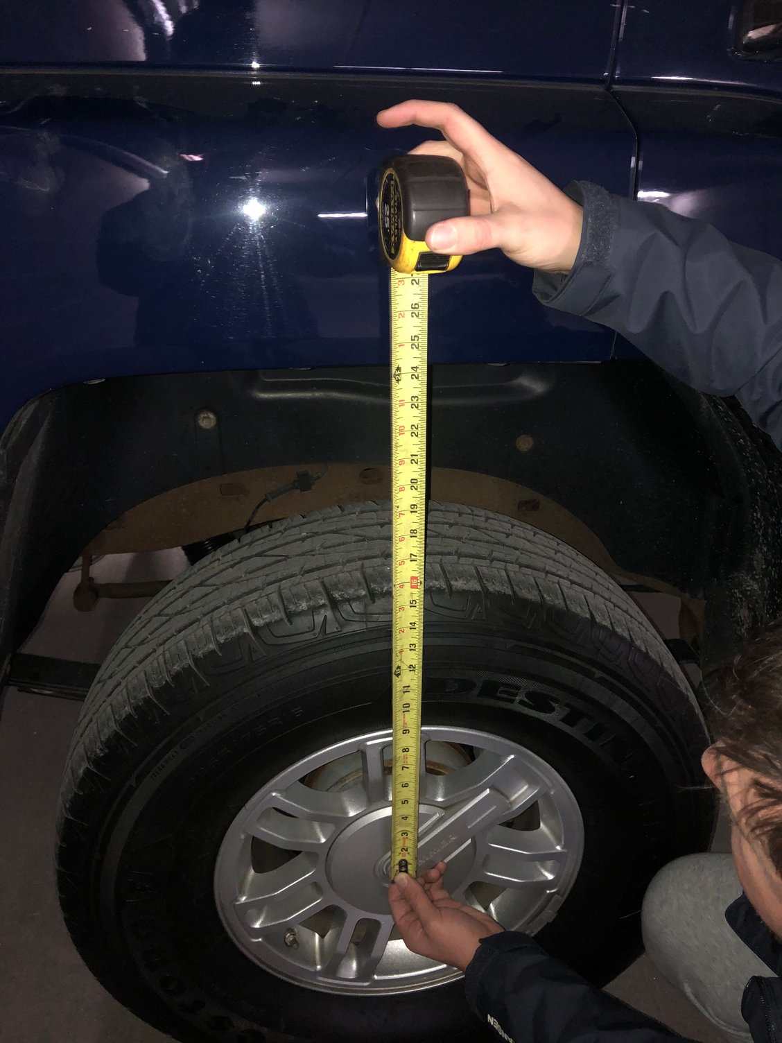

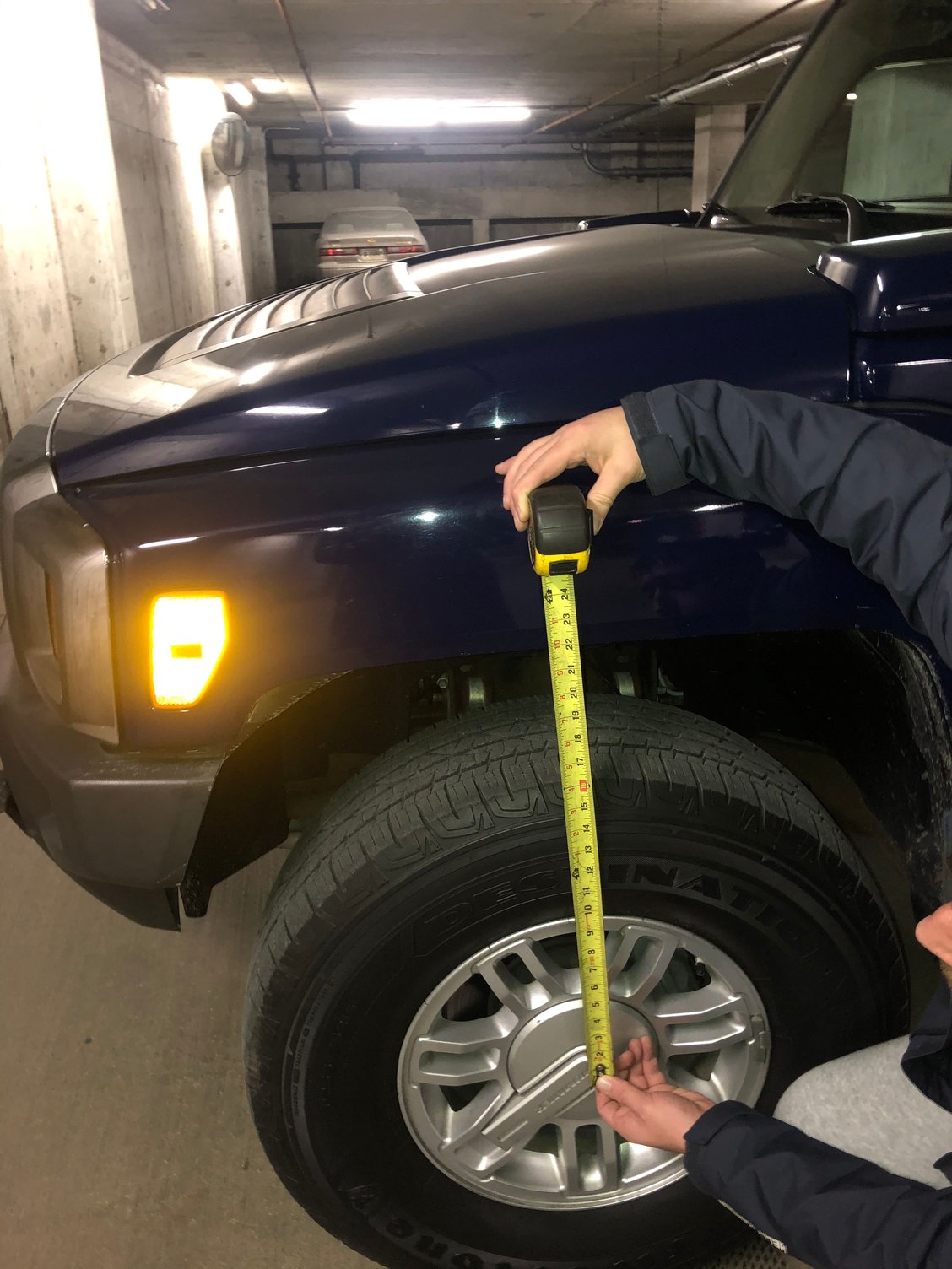

Old Dec 20, 2019 | 07:30 PM
  #29
Originally Posted by Bricks
Could the Tbars cause the bad sway/roll on the highway?
Measure center rim to fender on all 4 corners and post the results:
Old Dec 20, 2019 | 10:49 PM
  #30
Bricks's Avatar
Joined: Dec 2019
Posts: 34
From: Chicago
Front srivwr
Rear drivwr
Rear passenger
Front passenger
