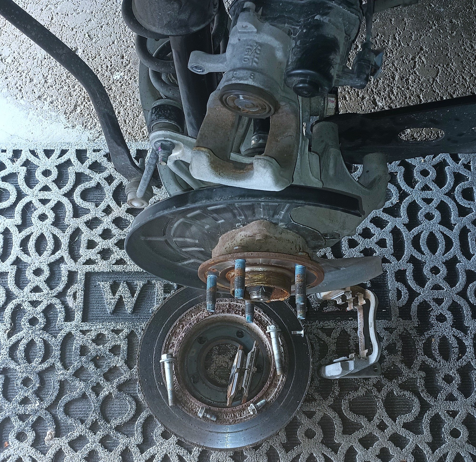

Default GMC brake service mode for electronic parking brakes
My wife wanted new brakes on her 2020 GMC TERRAIN. 5yrs old next month only 29500 miles brake pads have around 75% remaining all around. Vine sent me free brake pads & Ebay sent me all 4 rotors for a total of $116 with tax shipped to my door.

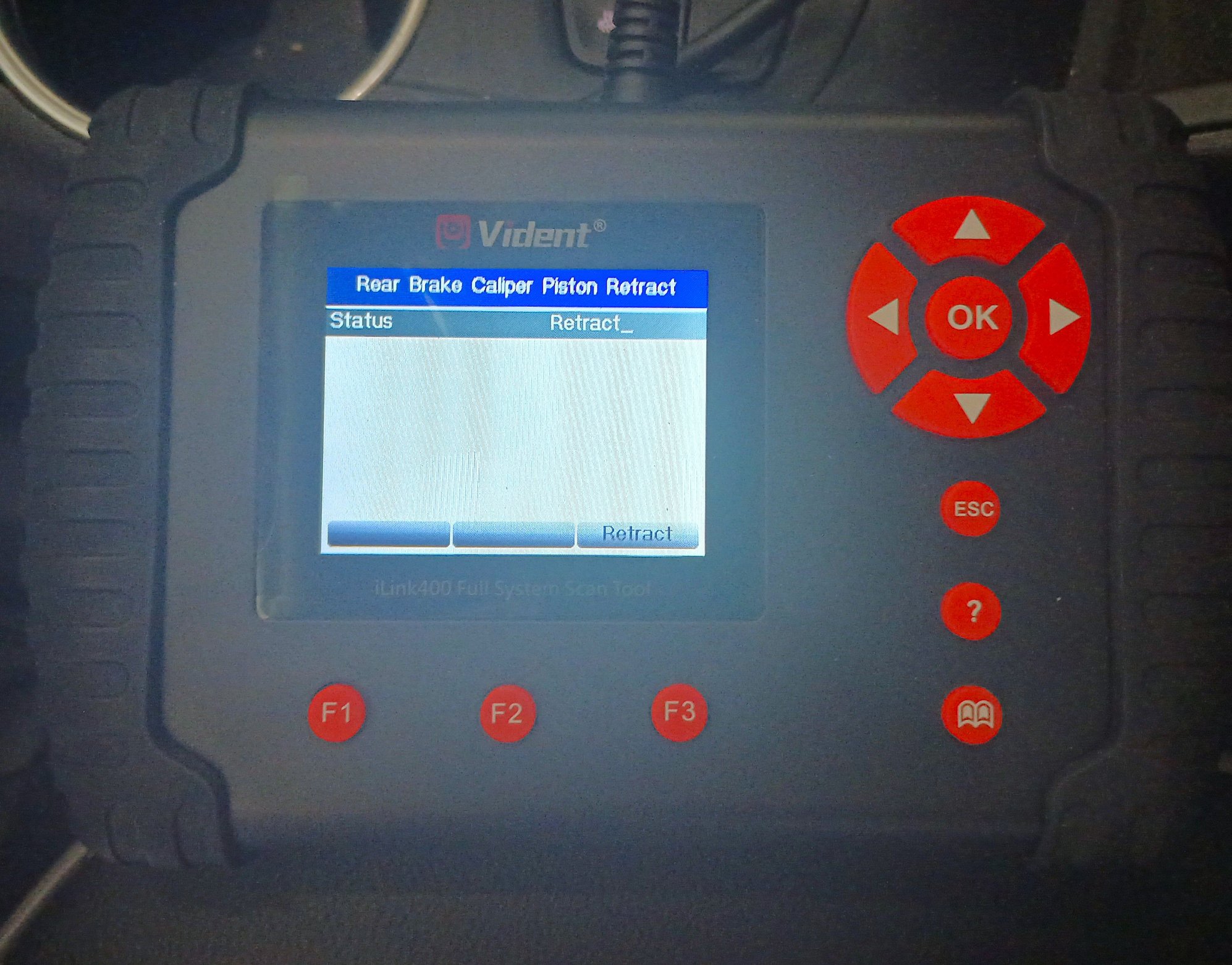

Front brakes replacement same as any brake replacement previous years however rears can't be replaced until electronic parking brakes are released then the caliper pistons can be pushed back in.
Vident iLink 400 to the rescue!
