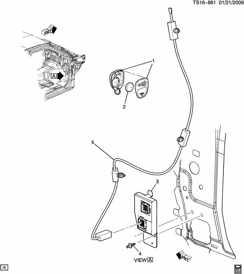

Your key fobs got nothing to do with your low tire light.
Same antenna. FREQUENCIES 433 MHZ 433 MHZ FREQ(XL8); FREQUENCIES RATING 315 MHZ LONG DISTANCE 315 MHZ FREQ(XL7); FREQUENCIES RATING 315 MHZ, SHORT DISTANCE SHORT DISTANCE 315 MHZ FREQ(XL6)
24300221(#5)
