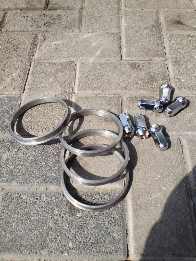

First thing to change was the wheels & tires and level it out. I bought a set of 18" wheels finished in chrome and a set of 12.5 35 18 Discoverer tires. I had stainless steel hubcentric rings made as the wheels had a lager hub bore than the H3 has.

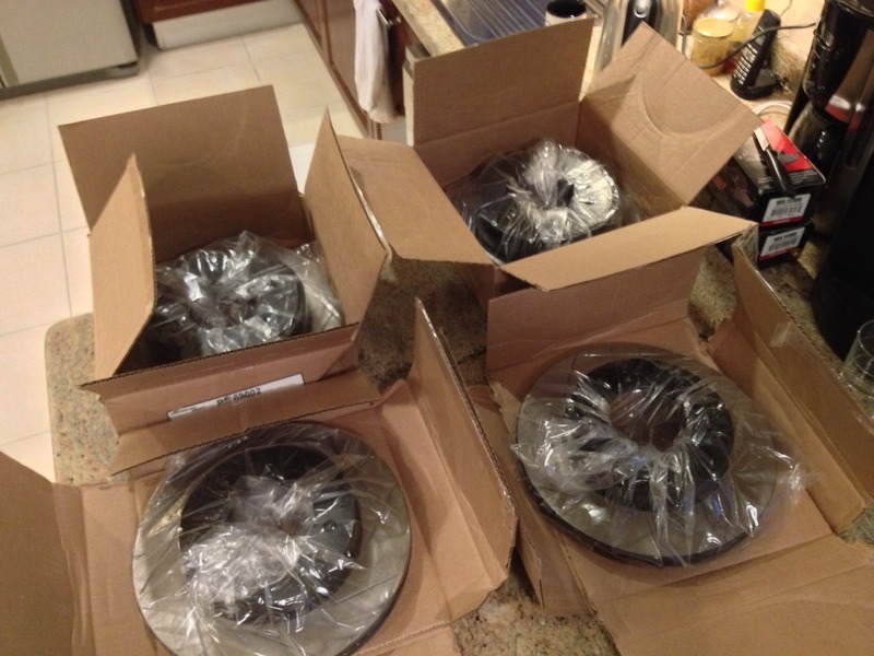

I went with R1 Concept premium slotted rotors as I've had success with them on other projects. I also went with their offered ceramic pads;

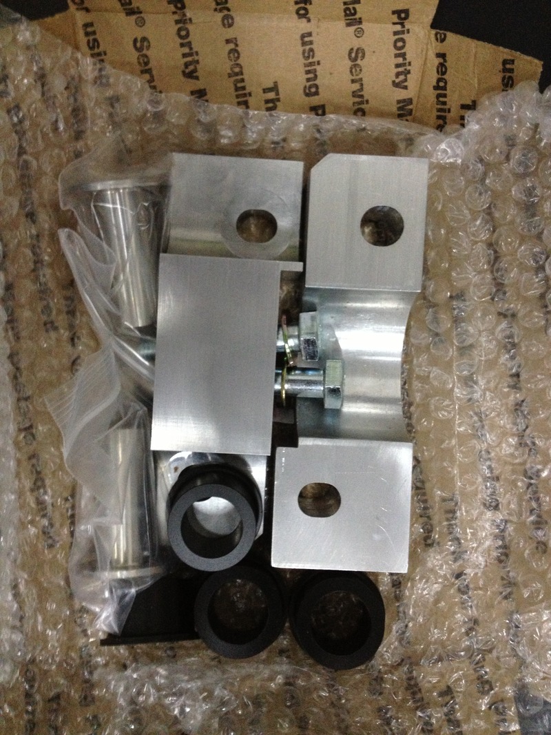

The last thing I added was a steering rack reinforcement kit from Outfitter Design;
As expected, everything installed as it should, no issues at all. Next up, some power performance mods.

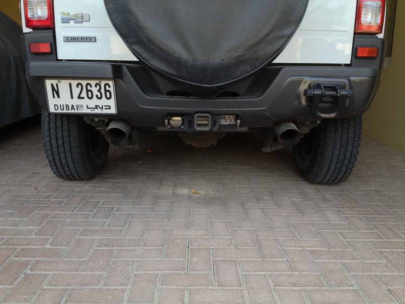

I already know these obnoxiously large and ill placed tips are going to cause problems later on...
