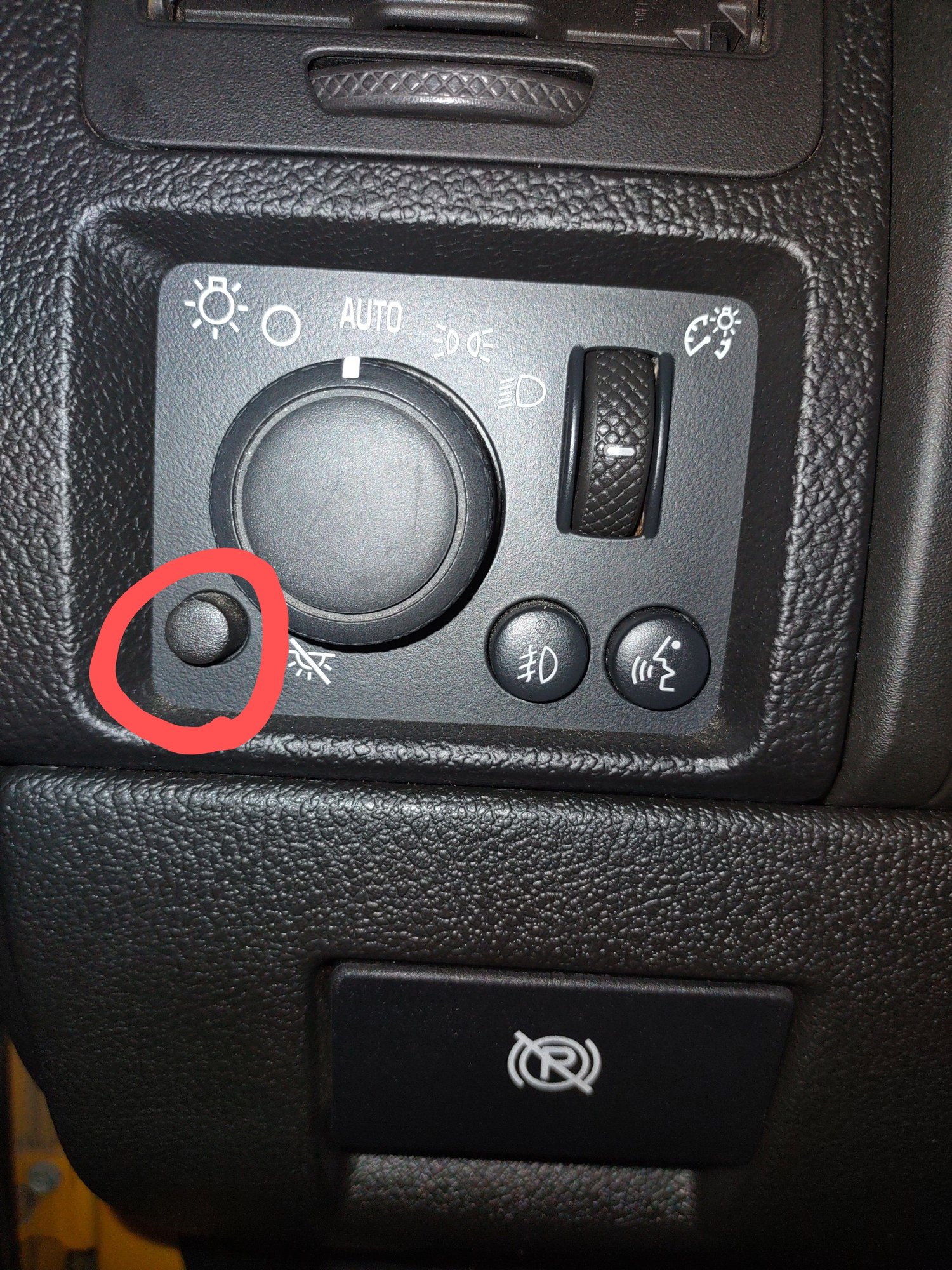

I just realized that I have forgotten about the small circular switch located at the bottom left corner of the Light control area.
This switch may have been "pushed inward" which would shut off the interior lights!
The key must be turned to the ON position or in the Start/Run position for the lights to be OFF.
Once you play with the button you will see what I mean. Maybe that switch is the reason why the overhead interior lights are not working. I will post a picture of the Light control area...I created that name because I can't remember what it is actually called.

This is the circular button switch that can turn OFF the overhead interior lights!
