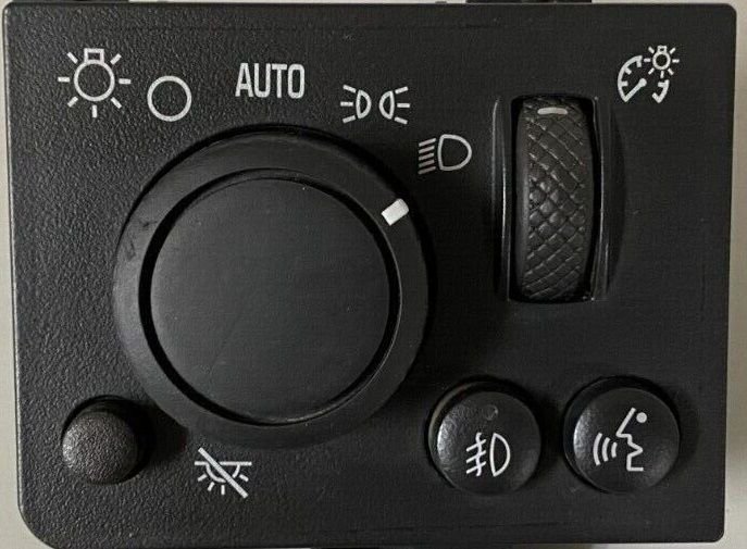

The only thing I haven't messed with is the light switch unit and the BCM

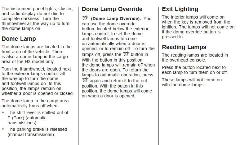

Easy stuff first....... The light switch can be used to turn off the interior lights, check the Owner's Manual. If you are using new LEDs, they are polarity specific. I assume you already crossed that path.
Do a voltage check at the dome lights to see if there is a connection. Clean the bulb holders with CRC Electronics Cleaner.
