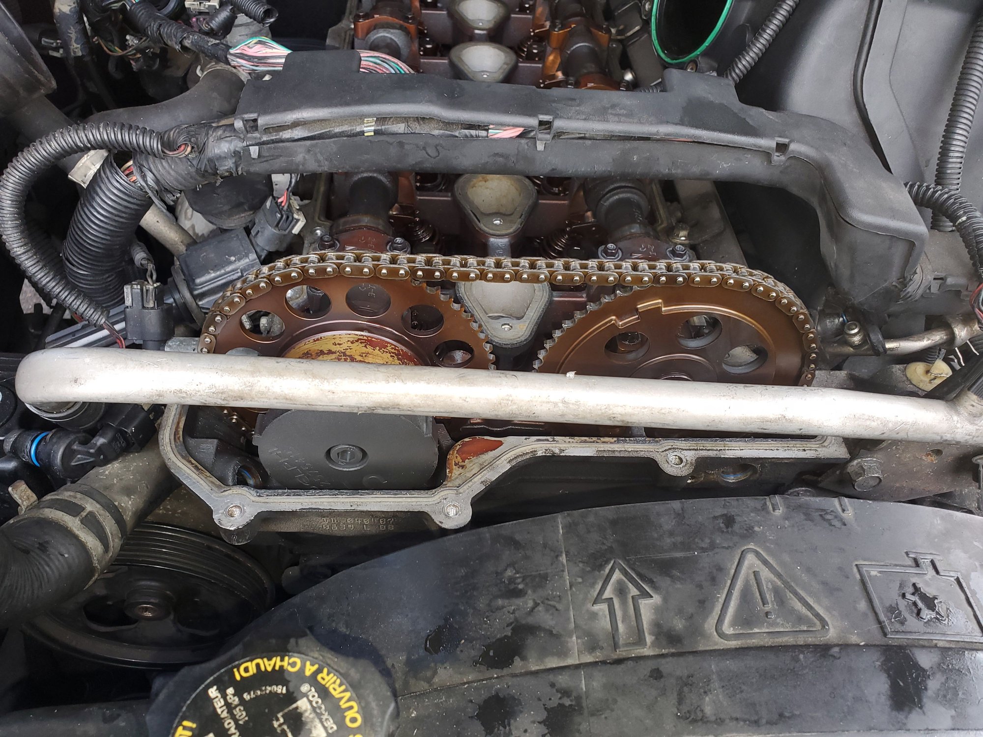

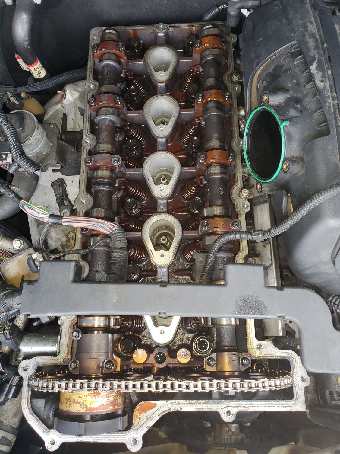

Well, it's been a minute...but I finally got the valve cover off. Shockingly, the timing chain does not appear to be broken. At least, not the part I can see (see pictures). Honestly, I was sure it was broken. I need to turn the crank and make sure the cams are turning as well, but I think unless it broke in two spots or somehow the crank sprocket broke, something else is wrong.
Assuming all of that appears intact, it probably makes sense to replace the chain and the tensioner while I have it apart, given the >180K miles. Not that I want to do all that with a still-not-running vehicle, but if I don't have a ruined engine after all, it's most likely going to be worth fixing, whatever the issue is.

Have you rotated and aligned the cam sprocket marks to the chain? Can't see the crank, but you could pull #1 spark plug to measure for TDC.
