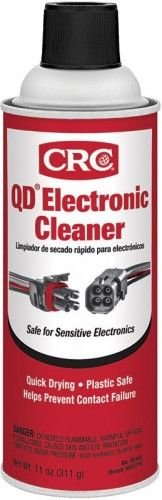

Pull the connector to the ignition switch and clean contacts on switch and connector:
