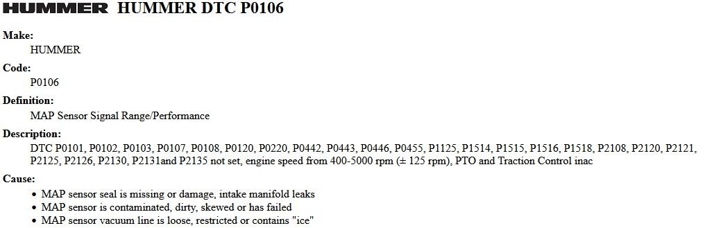

MAP not MAF
Originally Posted by beltz0826@gmail.com
I switched coil 5 and 4 around again (boredom) and still a misfire on cylinder 5 and also got code p0106.. was looking to replace the map sensor but there isn’t a ac delco one?? Any suggestions?
