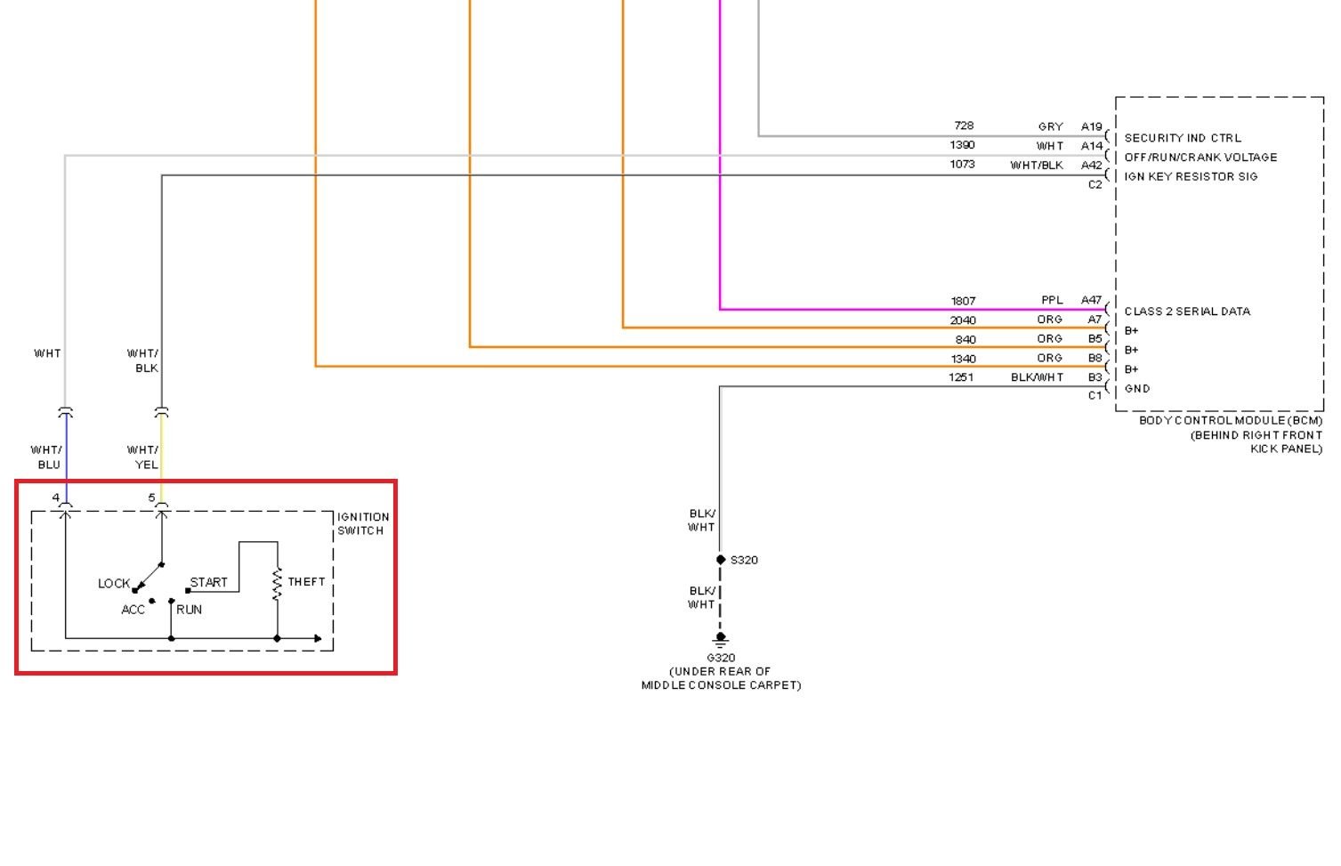

Originally Posted by The Big 'O'
this is getting really confusing now... so, I found a photo of a cylinder casing for a h3 and it shows three wires leading to a hall sensor in the casing.. i understand the logic, the magnet alters the resistance which changes the voltage going down the reference wire to the bcm.. only problem with mine is.. it doesn't have any wires going to a hall sensor.. it has a live and ground going to the key retention solenoid and all other wires come from the switch.. anyone able to shed some light on this? I know I must seem a little thick but Im just doing my best to learn as i go...
Already stated above there are no chips in the keys...H3 PASSLOCK SYSTEM IS BCM TO IGNITION SWITCH!

Look again at the video of my unmolested original factory installed wiring harness '07 H3 I posted above showing startup> WITH IGNITION SWITCH & KEY NOT IN THE CYLINDER:
thanks buddy... i dont know if my programmer will do anything on this system ( its an Autel 508s ) but certainly worth a go...
I have oredered a remote start, that might provide a solution.. im back there on thursday so i will check all the wires coming out of the switch to see if the match up to what a passlock 2 wiring should be ie 5v reference etc..
You would need HP Tuners, not a bidirectional scanner.
Old Sep 17, 2025 | 02:46 PM
  #25
Posts: 13,105
You have been overthinking this. The switch is what passlock looks to to deny a start, not a key or super secret hidden magnet hall sensor or resistor.
It was simple, but you complicated it be throwing away your old ignition switch. That might have started it. Now it is like you had a complete ignition switch failure and you need to program in your new one. The other option might be a passlock deleat, which also takes programming.

Follow the ignition switch reprogramming using the vehicle, step for step, no shortcuts, and CHARGE THE BATTERY COMPLETELY BEFORE YOU DO! You car battery must be fully charged or it will NOT work.

The guy in the video that hummerz posted refers to the ignition switch as a "sensor". It is NOT, just so we are clear.
