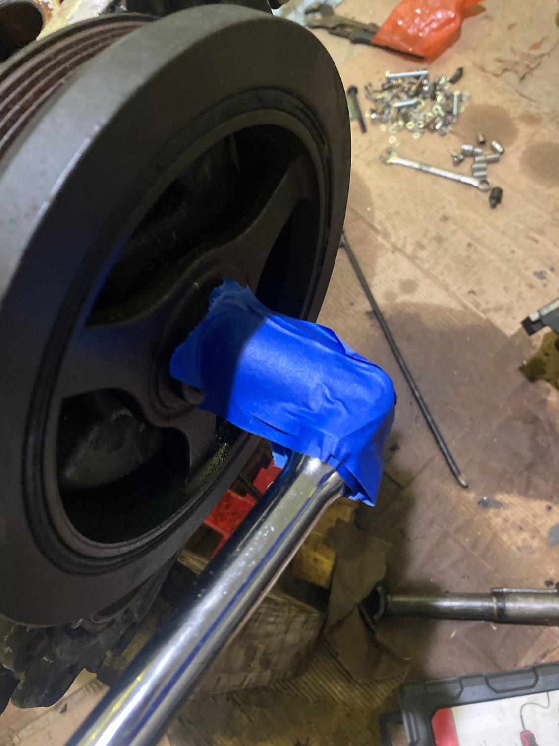

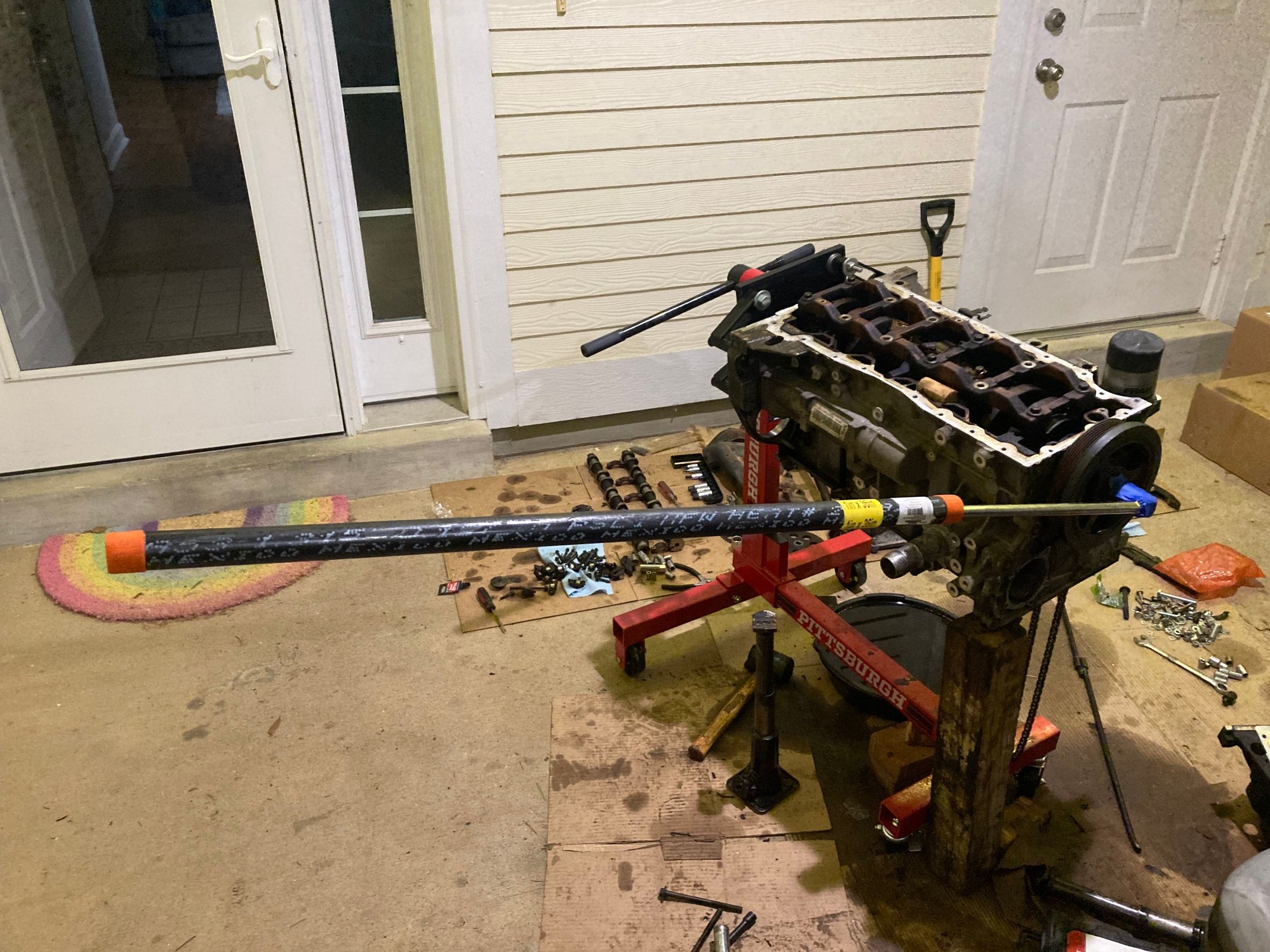

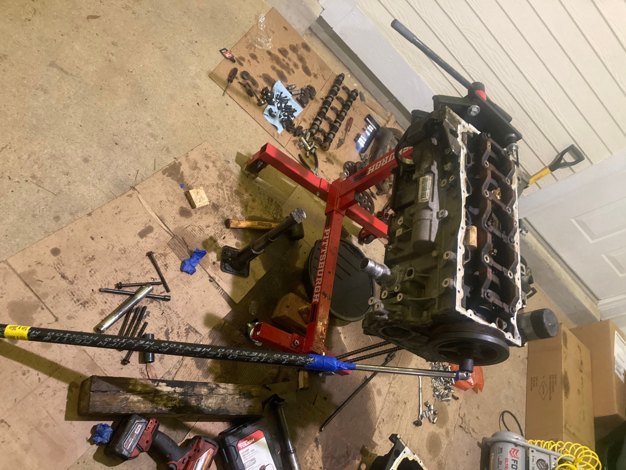

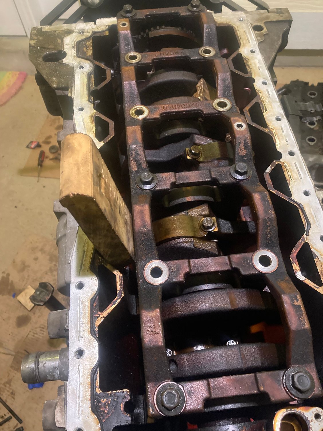

In order to remove, then properly reinstall the the front timing cover, you’ll need to remove the oil pan.
I would recommend draining the oil, pulling the pan, then take a block of wood and jam it in between the crankshaft/connecting rods and the engine block to hold the engine in place when removing the harmonic balancer bolt.
I’ve attached a photo of when I had my engine on the stand; this is the method I used to remove it.
For loosening the actual bolt, all I can say is good freaking luck; if your engine is anything like mine, this was one of the most stubborn bolts I’ve ever worked with. My Milwaukee Impact Wrench wouldn’t even make a dent in it. I had to use an impact rated socket, the largest breaker bar I had, AND a cheater bar on top of that. It was extremely tight.

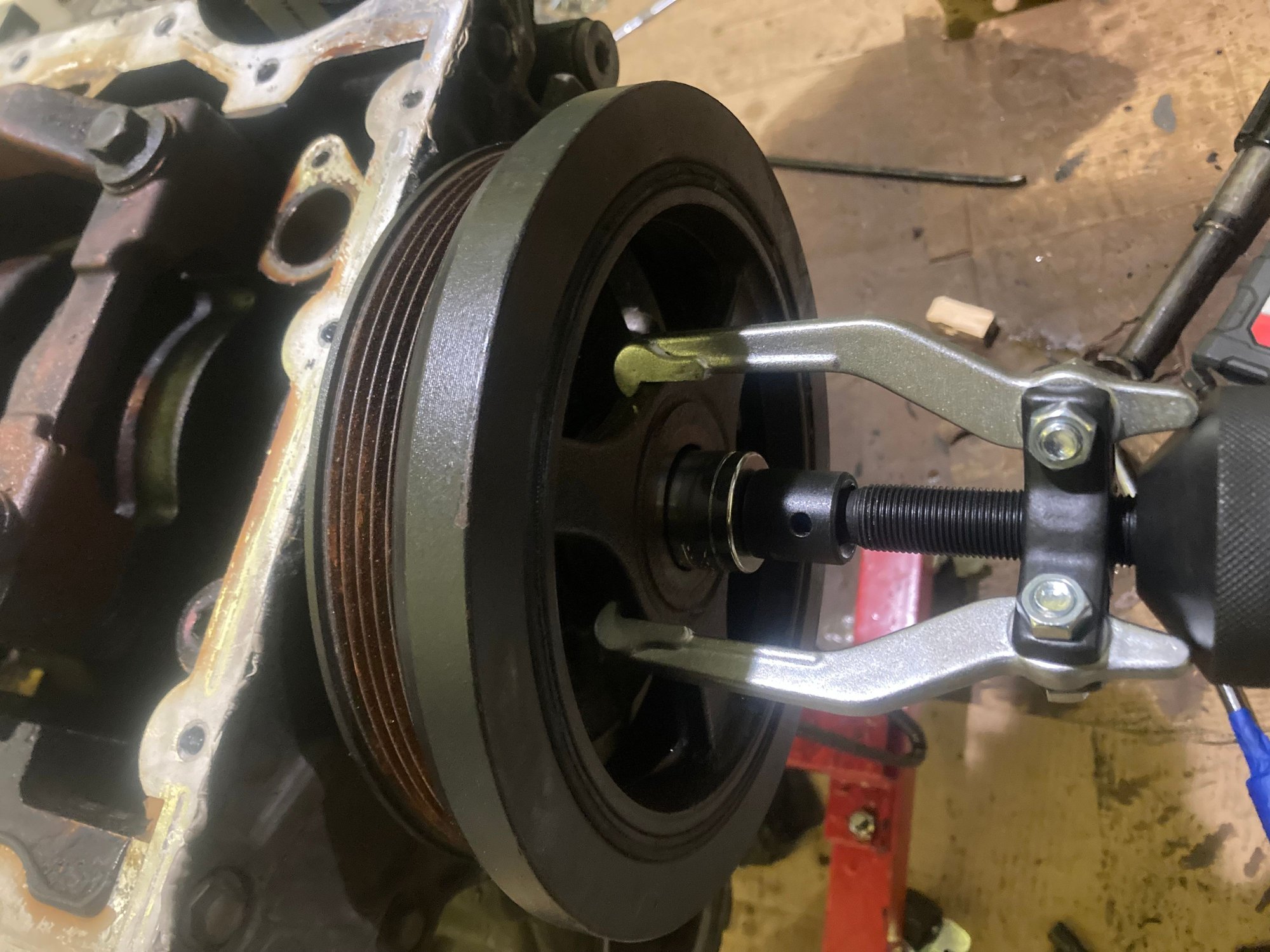

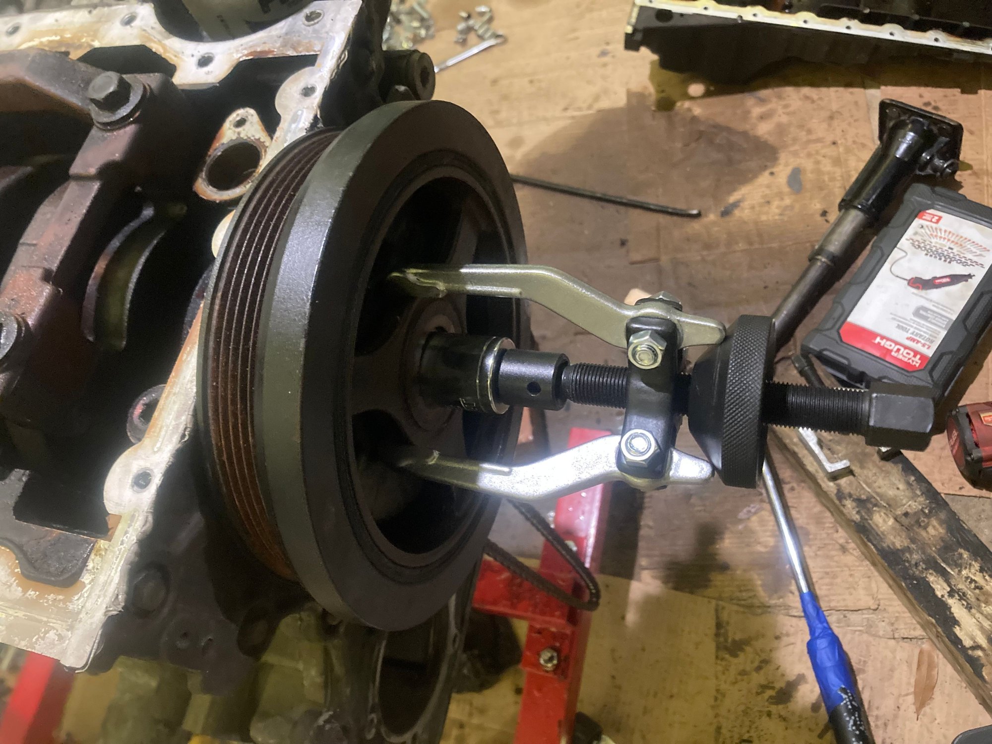

Once I had the bolt removed, you can use a harmonic balancer remover tool to remove it, or you can get away with improvising with a Maddox slide hammer kit.
I don’t think GM makes the harmonic balancer bolt for this engine anymore; the engine rebuilding manual says to get a new bolt, but I was able to reuse mine with (knock on wood) no problems so far with 7k miles on my engine.
