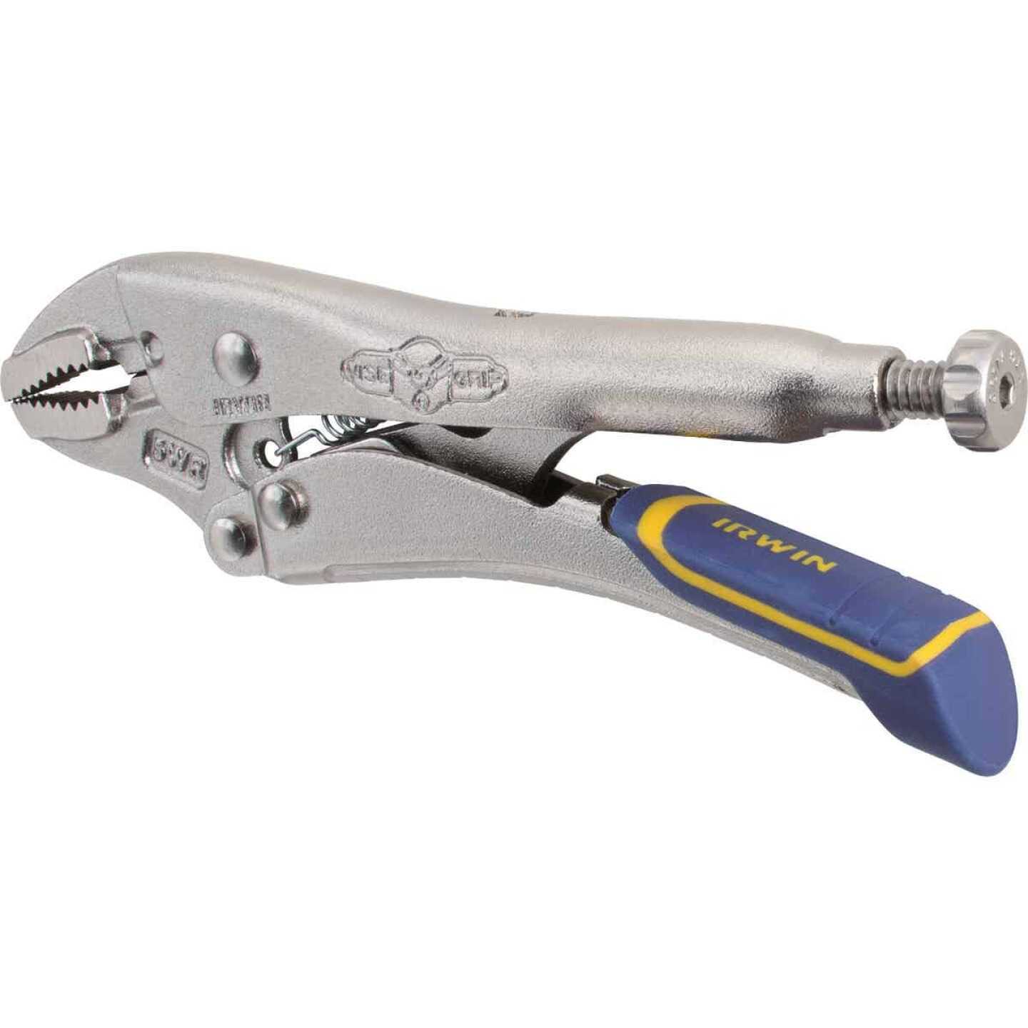

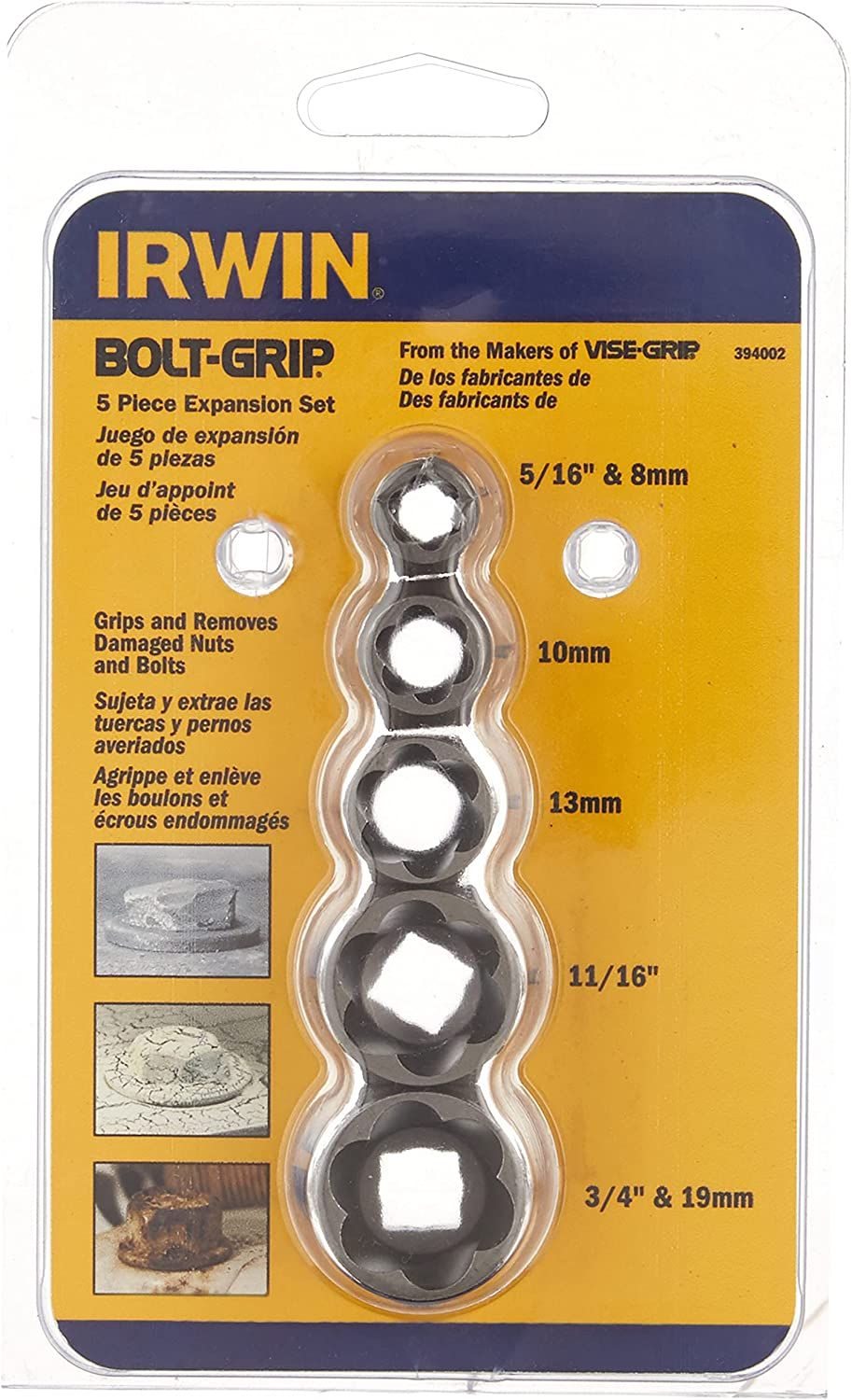

Posts: 9,015
Got a set of Irwins? Bolt extractor? Chisel? I've had to remove numerous rounded bolts over the years, and never been defeated! YT vid shows many ways I have used over the years:
Old Mar 12, 2023 | 02:10 PM
finall's Avatar
Posts: 831
From: Pacific NW
Pictured above are those were the bolt extractors I spoke about further up in my prior thread.
If you do not have any of these tools, then I suggest you grind new flats onto the bolt, just small enough to fit the next size down socket. Then take an old socket, and pound it on tight. That will remove the bolt.

Oh, and avoid vice grips, plumbing pliers, etc. Those usually do not provide enough torque and tend to slip off, and lead to more bolt head or nut rounding. Unless you are using them on bolts less than 1/4" diameter. Speaking from lots of experience.
