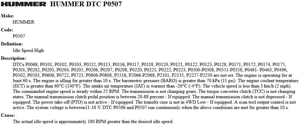

Ok, after diving it it's better it's trying to hold about 1000 rpm it's better but not normal also got a code for a p0507 so any advice going from here ? No other codes and it's running way better but just need to finalize it . Thanks in advance .

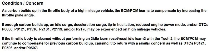

Originally Posted by H3Forlife
Ok sounds good . Yea it had 150,000 when I first bought it and now has 197,000 so yea that's to be expected and I'm guessing I'm the first one to take it off and clean it 😂 . Thank u ill let yall know something soon.
Yep, lack of maintenance has brought you to where you are. Not a big deal. If you drive it eventually, and it will take a while, it will re-learn the proper throttle position over time. Or, you can use a capable bidirectional scanner to force idle changes back in place much quicker.
