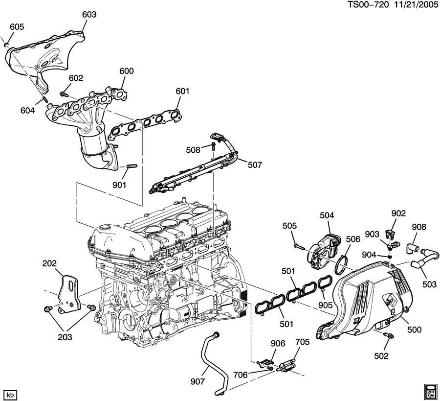

#907 EVAP (Evaporative Emissions) Line. Connects to the EVAP Purge Valve (Solenoid) #705 at the other end.
Inside the TB Throttle (Hall Effect) sensor there are some plastic parts that do not play nice with Carb Cleaner..... plan from here out using Throttle Body Cleaner ONLY.

Ok thank u ill give it a look and report back . Thanks for all yalls response . Also would appreciate the name of that plastic vacuum line that plugs into the TB?
Purge valve tube. 12577221

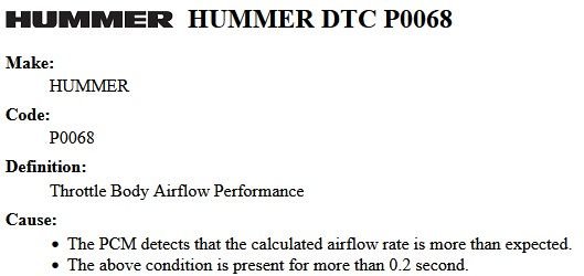

Ok sounds good . Now I will say I did get a p0068 which is what started all this so idk if I should put the oem TB back on what's your opinion? That code is a throttle position code.
Carbon build up in the throttle body and/or leak.
Old Aug 7, 2023 | 02:43 PM
Posts: 13,105
You can answer this on your own. When was the last time (how many miles ago) you cleaned the TB before that code? When was the last time you changed your Air Filter before that code?
Crud gets built up and/or the butterfly will not close completely.
