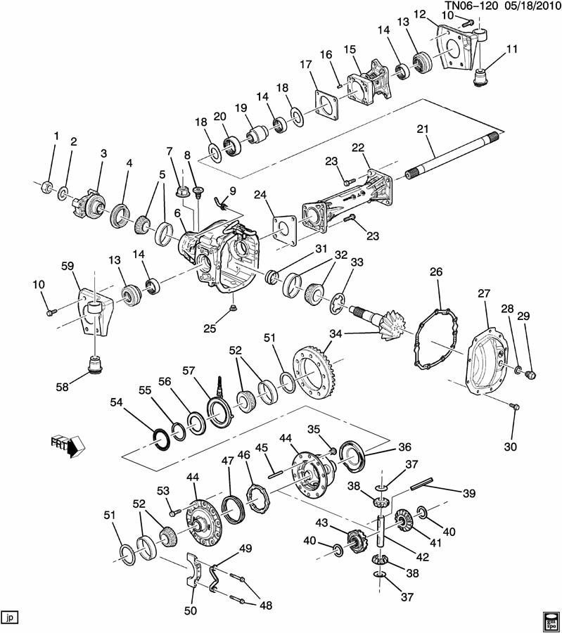

Could somebody please tell me what this part is called and maybe where I can order it..
Old Aug 10, 2023 | 11:45 AM
Can we call it Rusty?
Sorry...... Welcome to HF.
That is one of the two smaller/side front differential bushings. There are three total, the two smaller ones (#11 & 58 below) as well as the larger center diff bushing in the cross member shown farther below #8. If one is bad, you should do all three.
If you want to do it right, look at this. H3 D.I.Y. FRONT DIFFERENTIAL BUSHING KIT

Outfitter doesn't have any kits and no ETA. Consider:
https://www.jeeperf.com/product-page...ings-set-all-3
https://www.badlandindustries.com/pr...ntial-bushings
I'd say there really aren't any good options. The OEM part is discontinued. front axle mount RH 15856421
