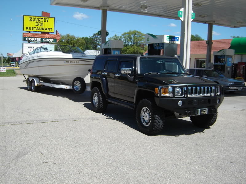

Posts: 13,111
I ran 305 MTZs on my 07 Adventure for a decade with all the performance mods (Air Doc Intake, PP TB, MagnaFlow Cat back, PCMofNC Tune, CFS Aluminum Radiator) and it could hang with most all full sized PU/SUVs even in full off road gear. Towed a damn tandem trailer with Big Block Chaparral Bow Rider back to NE of Detroit from just S of Milwaukee..... the I5 is not under powered, but I would not run 35s on it either.
IMHO, that is THE tire size for an I5. Same diameter as the 285, same width as a 315.
