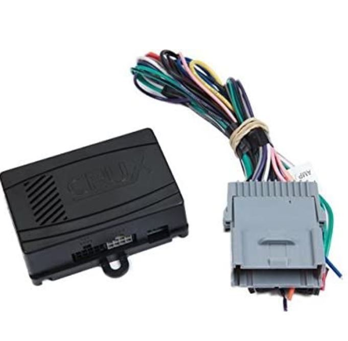

Old Aug 21, 2020 | 05:26 AM
Taint, what radio adapter did you use for the H3T installs?
With Monsoon I use Crux SOCGM-17C -
Amazon Amazon
Simple install with the new solder seal wire connectors. I use them on everything 12V now.
