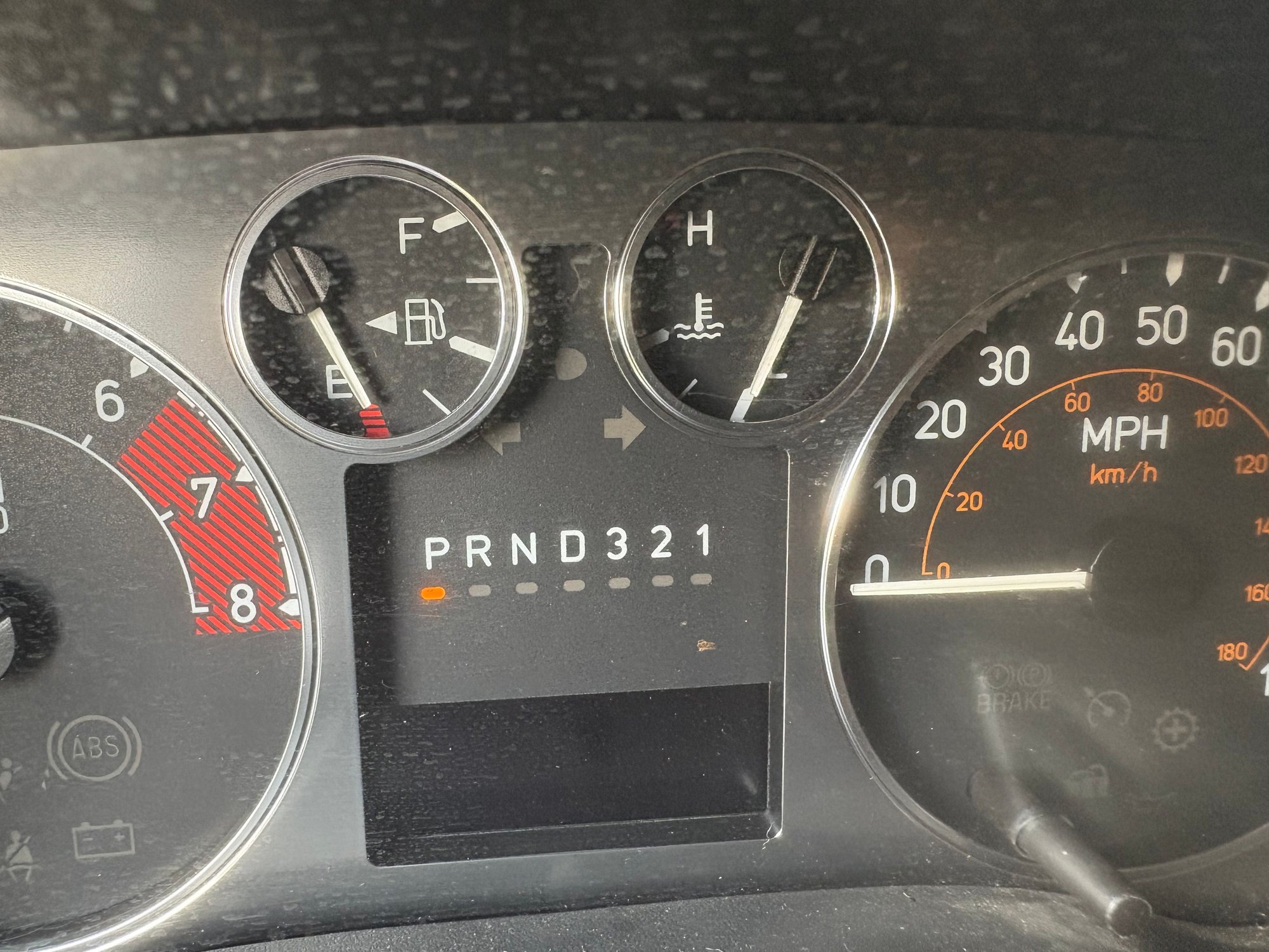

Need help: 07 H3
Battery went dead the other day. I charged it and now the ‘P’ stays on, radio stays on, and chime is dinging. Even with the key out the ignition. Have to disconnect battery to prevent draining
-ON position works
-Key turns to START but will not crank.
-I installed a new ignition switch today. Same thing.
-Passlock was deleted last year by BCM programming.

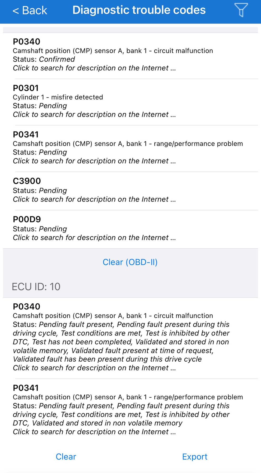

Scan ALL modules then post the codes.

Disconnected the (recharged) battery for 30s. Reconnected and boom. Started right up.
I can’t believe this.
Will scan for codes. Thanks.

Any thoughts on these, when I just replaced both cam sensors and crank sensor

Hummer H3 codes P0340 and P0341 both point to issues with the Camshaft Position (CMP) Sensor "A" circuit. P0340 indicates a general circuit malfunction, while P0341 signifies a range or performance problem. Common causes include a faulty CMP sensor, wiring issues, a loose or damaged electrical connector, or, less commonly, a problem with the engine's timing components.
This video explains how to fix the P0341 engine code:
Potential Symptoms
You might experience symptoms like:
  • Hard starting or intermittent starting
  • An engine that idles too low or too high, or has a "rolling" or "surging" idle
  • Misfires or a rough-running engine
  • Loss of engine power
  • The engine stalling
Possible Causes & Solutions
  1. 1. Faulty Camshaft Position (CMP) Sensor:
    The sensor itself can be damaged or dirty, leading to incorrect readings.
  • Solution: Remove and inspect the sensor. Clean any dirt, metal shavings, or sludge with a clean cloth to improve its signal.
  • 2. Wiring and Connector Problems:
    Loose or broken wires and damaged electrical connectors can cause a circuit malfunction.
  • Solution: Carefully inspect the wiring and connector for the CMP sensor for any damage or corrosion. Try pushing the connector together to ensure a secure connection.
  • 3. Timing System Issues:
    Although less common, problems with the timing chain, belt, or tensioner could cause the camshaft timing to be off, triggering the sensor codes.
  • Solution: If the sensor and wiring checks don't resolve the issue, a mechanic should inspect the engine's timing components to ensure they are correctly synchronized.
  1.
Next Steps
  1. Inspect the CMP Sensor: Check for any obvious damage or contamination to the sensor.
  • Check Wiring and Connectors: Ensure the electrical connection to the sensor is secure and the wiring is intact.
  • Diagnose Engine Timing: If the above steps don't work, the vehicle may need a professional inspection of its timing components.

Clear all codes and see which come back. Then your have relevant data.
