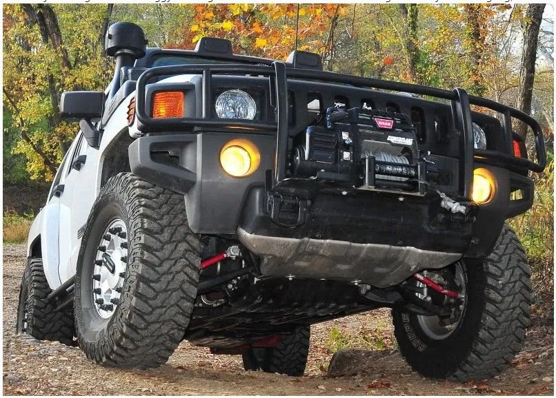

I saw this on another HUMMER forum and thought the long-timers here would appreciate knowing.
HUNNER was a great source of modifications and knowledge in the early production years of the H3 with his "HUNNER Edition" H3. Dave started off with a white 06 and then a white 08 Alpha.
*His "HUNNER Skids" saved many a rear shock mount and rear leaf spring mounts.
*His HUNNER shock nut trick prior to extended shock offerings by manufacturers.
*His knowledge and tinkering with the torsion bar adjustments also provided us with the 23.5" max.
*HUNNER extended bumpstops (progressive dampeners) lead to the aftermarket manufacturing of them.
*His steering rack reinforcement was the first such on the market making way for other companies to perfect it (Outfitter Designs and others).
*His custom tie rods also spurred others to modify them for strength and longevity.

Just a few of the many mods HUNNER did to his H3s.
Here are a few of the mods
Cooper Tire STT 315
5 on Hutchinson double bead locks
Mud/Rock Compound and muddin on Cooper Armour tech carcass 3ply sidewall 1 angled. Tough when aired down.
Second Spare Tire on Beadlock
Winter tires and road trips
Mounted on 5 Hutchinson bead locks
Hybrid aggressive AT mild mud tread on Cooper Armour tech carcass 3ply sidewall 1 angled. Tough when aired down.
Second Spare Tire on Hutchinson bead locks
Hunner Beadlock Wheel and Bolt Protector Rock Rings
To protect Hutchinsons 6
5 spare Hutchinson bead lock rims (investment)
General Motors
Spare OEM Aluminum Hummer rims 11 I think?
Power Tank Brand
Tire Repair Kit #8131
Staun
Tyre Deflators
Modifications - Audio -
Apelco Marine Electronics
VHF Radio carried only for use in my Yacht repair business. Not land to land.
Cobra
WXST CB Radio and weather
Radio Shack*
Mag Mount CB/weather Ant
$40.00
Replaced with truck stop unit
Wilson cell booster and outside antenna
General Motors
SiriusXM Receiver Active
ONSTAR Service Active
Radio Shack
Weather Radio Alert
Modifications - Engine
ARB Snorkle
Hunner EXtreme
Air Intake Tube
Turbo boot transition
Turbo boot 90 degree
SyKlone Pre-filter
Wix dry filter
STP dry filter (still think the paper is the best)
SyKlone Pre-filter
$200.00
Exide dual terminal deep cycle AGM
AGM Deep Cycle #1
AGM Deep Cycle #2
Custom Battery Cables with Hydraulic Swedged Ends (no wimpy set screws)
Hunner custom dual mounting mod
Jegs
Battery Insulation and Tie Downs
Superchips Flashpaq
Engine Tuner 2865 mostly used in tow mode
ScanGuage II Code Reader (very handy in the boonies read codes and to reset code)
Computer Readout
Modifications - Exterior - approx. $3,618.76 and counting, counting a lot more now!
3M Non-Skid Tape on rock rails
3M blind spot mirrors, big round like in the mini-mart!
ARIES AUTOMOTIVE ACCESSORIES, INC.
OEM "style" Roof Cross Bars (have heard they were the manufacturer of the OEM by someone working there)
You just have to install the letters for brand protection reasons? lol
Mounted third cross bar
One spare cross bar
Replaced my prototype 1/2" longer Hunner Frankenstops made from two OEM
for Trail Duty 1/2" longer firmer bumpstop (springs) as GM calls them. Thanks Phil and Nugget
Extended adjustable Currie fabricators custom cut front anti-sway bar links.
Blitz
Metal Can Mount Tray #1
Blitz
Metal Can Mount Tray #2
Blitz
5 Gallon Metal Fuel Can
CQR Anchor
Anchor for mud, sand no vehicle or trees to pull to.
Bruce Anchor
When one is not enough!
Custom
Over Spare Rack large Paul
Custom
Over Spare Rack small CB
DefenderWorx
Hummer Black Locking Fuel Door
Highlighted Hummer letters
General Motors
SunRoof Option
Hitch Cover
Black Mirrors
Black door handles (swapped with dealer
General Motors
OEM Roof Mounted Lights
$370.00
Generic Lights
Rectangle Backup Lights
$35.00
HiLift Jack 60"
Large Base Plate (you need this) paid for itself on the beach!
HUMMER/GM (OEM Part)
Towing Hitch
Rear-View Camera
Luggage Carrier Cargo Tie Down Loops alot!
Grill textured black by Hunner
Magnalight.com
GoLight Radioray 2051 #1
Wireless remote control
Magnalight.com
GoLight Radioray 2051 #2
Wireless remote control mounted on cowls
Pair of Ext Range FM walky Units
Nokya KYO H10 Wire Harness
$15.00
Nokya
Yellow Foglight Bulbs
$45.90
Putco dechromed textured black
Side Marker Covers
$59.90
Quik-Fist Clamp
Shovel mount
RainX
Wiper Blades and fluid
DeLorme
Hocky puck GPS
Streets and Hwys Software upgrade 2011
Southwest Quads Software
DeLorme Topo USA
PN-40 GPS
Garmin GPS
RAM Mount Laptop Mount designed for H3 (guess how that happened)
Toshiba 12 Inch Laptop
With drive shock protection
ipad II
ipad pro 12.6 inch on pedestal mount
6 CD AM/FM Monsoon Radio
Universal Garage Remote
Heated Leather Seats ahhh
Floor Mats - Front and Rear Premium All Weather rubber logo
Panavise Products, Inc.
Mobile Accessory Mount
For cell phone
Modifications - Security
Night Owl NOCX5M Night Vision Scope
For Zombies
Modifications - Suspension - approx not complete $973.15 and climbing
Bilstein 5100
Front Shocks
Bilstein
Rear shocks
Connex Bushing/Hunner modded for Steering Rack 100,00 miles combined two H3's
Replaced my 1/2 longer Hunner Frankenstops
for Trail Duty 1/2 longer firmer bumpstop (springs) as GM calls them.
General Motors
Steering Gear Bracket #2 added a second one in the middle.
Upper a-arm Assembly 2 each spare
Torsion Bars at 23 1/2"
Hunner EXtreme design
SS Flex Line for Short Steering Rack Line (should do both)
$50.00
Hunner EXtreme Skids
Front Hanger protector
Rear Spring Rear Ubolt and lower Shock mount and bolt Protection
Innovative Motorsports
RAD1 Inclinometer oh snap meter
$89.00
Oklahoma Offroad
Front Limit Straps
$50.00
Custom length triple ply mounts bent in opposing direction to clear shock tower
Purple Cranium Half Spider
$94.15
HUMMER/GM when upgrading to Alpha
Cast Iron Front Diff Housing
Included like on the 06 but 4:11 gear
Rear Eaton Locker
Hood Handles (to hold louver on)
$165.00
Rocky Road Outfitters Super Sliders
Hunner mod, of course!
Rola Roof Rack
Rack Fairing
Rola Rack Extension
Extra mounts for third cross rail.
Rustoleum
Rubberized Undercoating
In areas of welds
Scepter
MWC (Military Water Container)
Heavy gauge pvc/vinyl
Sears
DC Impact Tool carried in tool bag
Husky jumper invertor/battery pack
Sears
Roof Top Cargo Carrier Container
Shopsar.com (E & G Classic)
Fender Flares and Flaps
$425.56
Hunner modded for 315 tires.
Fender Flares and Flaps set plus some extra pieces
For modding
Ridgedemon.com
Steelcraft
Tail Light Guards
$152.70
Steelcraft
Brush Guard W/Winch Mount
Sylvania
Silverstar Headlight Bulbs
US General Tool
Lt.Wt. Racing Jack
Carried in the H3
Warn
****** Block #1
Heavy Duty
Warn
****** Block #2
Warn
and 1 more for rigging reverse winching.
Quick Connect Power Leads
For rear winch.
Warn
Pos and Neg
For custom jumpers
Warn
Winch Mount Plate
$133.09
Modded to fit rear receiver
Wireless Remote
$138.08
Warn Winch
9000ti
Rear mounted for Expeditions
Warn
9500 Powerplant front with added air tank I modded
Wolo Electric Horns
$24.90
Modifications - Interior - approx incomplete $470.00
American Fire Extinguisher
ABC B402 5lb
Front
ABC B402 5lb
Rear
Brandmotion
Seatback Backpaks Hummer Design 2 each
$80.00
Custom
First Aid Kit
DayStar Dash Organizer
Oh yea
BulletProof Suspension Custom Tie rods (priceless)
I got to enjoy working with them to design changes to fit H3.
Probably more mods when I think of them. Including mods of mods!!
Knight Metal Works full underbody skid
Tatton drive shaft and 4speed's adapter
and many moooorrreeee......
