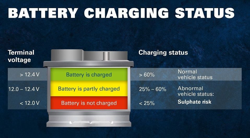

I Tried the relearn method still nothing. I went out and bought a jump box and a multimeter. Battery is at 11.3v. I’m still trying to wrap my head around all this because it was working just fine before alarm went off. This morning I had gotten in and the light was flashing just as you said on the relearn instructions. This was new because the past times I looked at the anti left light it was solid. Now there is no light.
