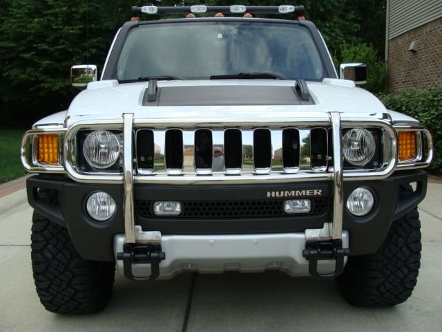

Click the link these look like they go in the lower Bumper Grill or in the top grill? Going to find a way to stuff a winch in the lower one but if its the top one its a cool option for sure. I purchased this hummer to be an off road toy not really a daily rig. but we live in the sticks and man its dark out here at night and these headlights suck!
Old Oct 28, 2020 | 12:34 PM
Broken Halo's Avatar
Posts: 1,461
They might interfere with a front mounted winch?? Here's a pic of them on my H3. You can decide.

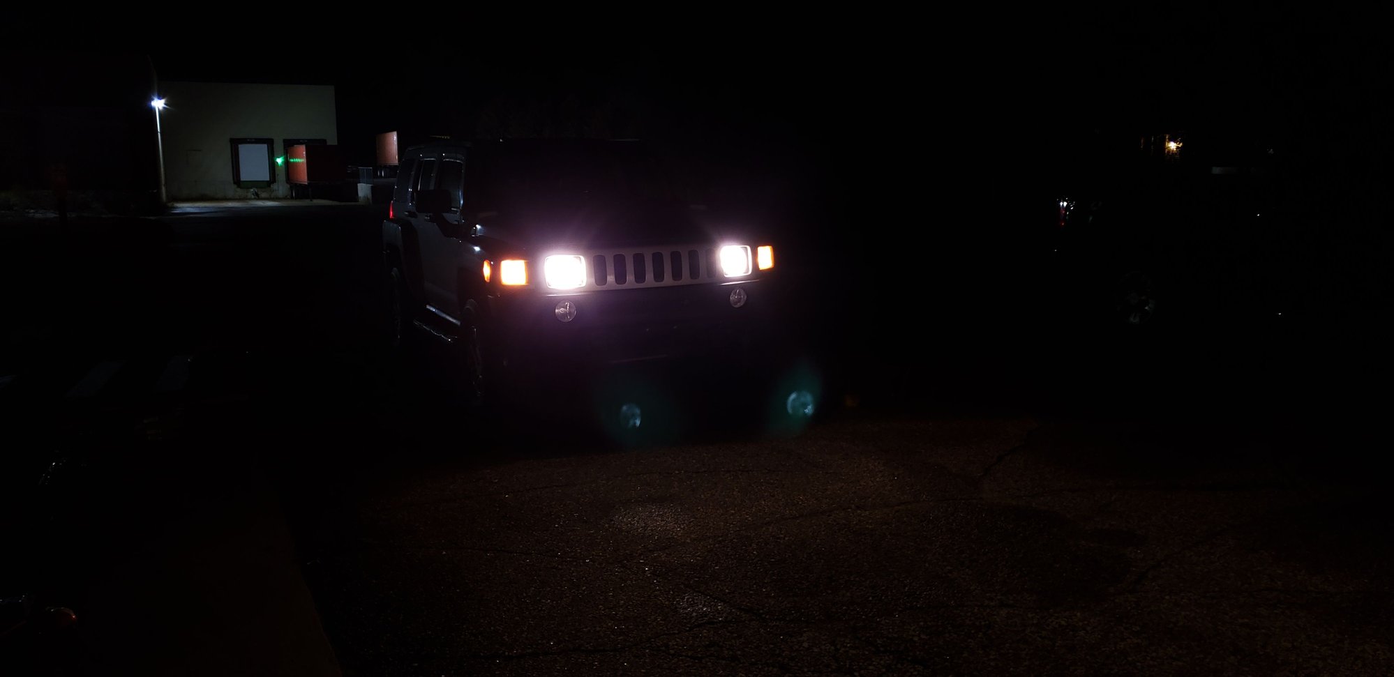

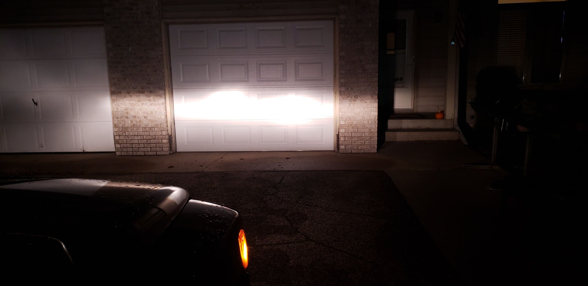

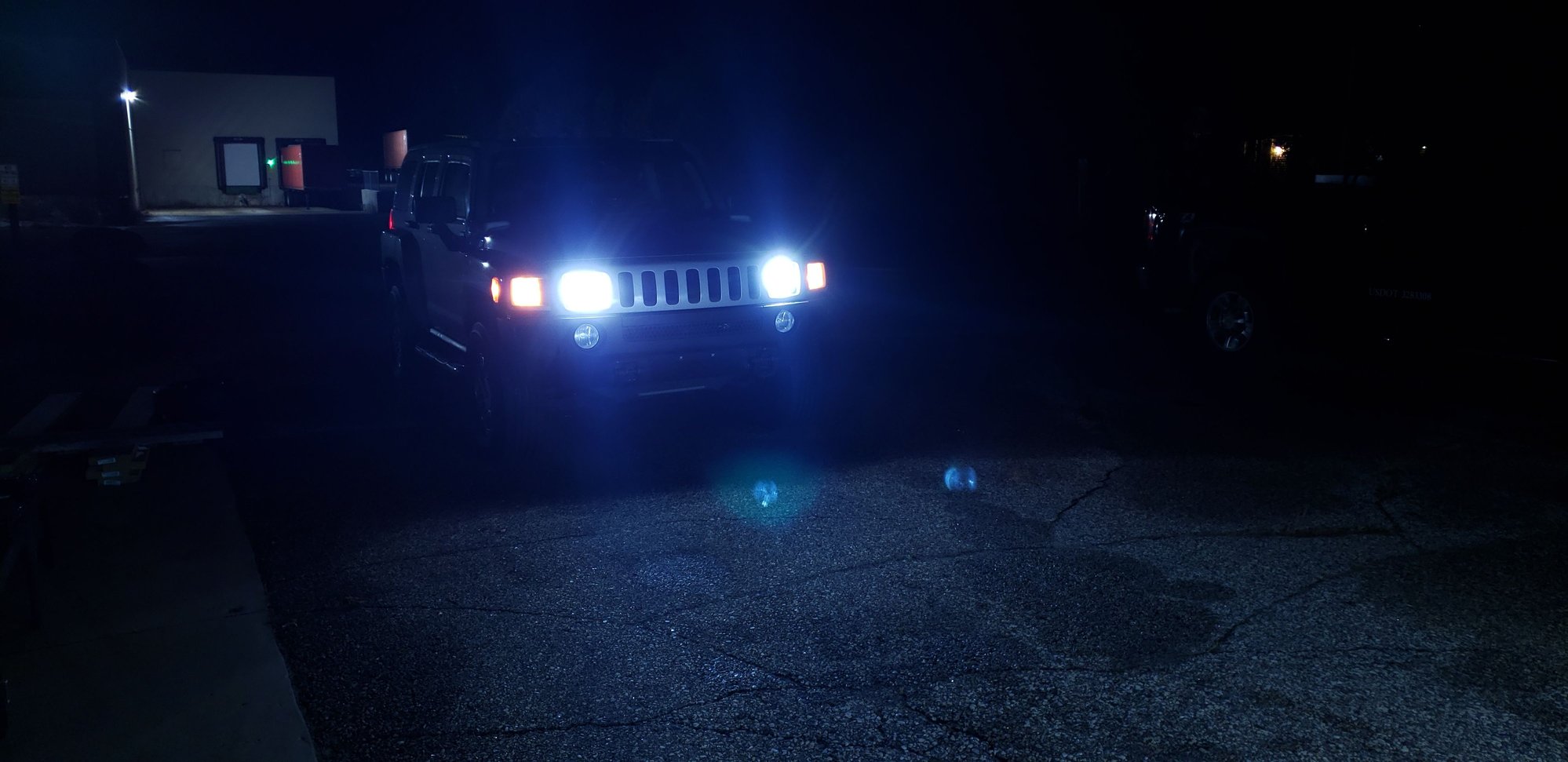

So, I went ahead and ordered LED bulbs from Headlight Revolution.
SUMMARY: I am happy with them, and they are an improvement, but they aren't a "blow you away" improvement. The color of the light is the biggest improvement, and I believe it increases the amount of light returning to your eyes.
DETAILS:
I ordered the GTR Lighting Ultra 2.0. These are not the cheapest, but after talking with a representative at HR I went with these. Install was very straight forward. The lights did need to be "clocked" for the Hummer (ensuring that the LED module was vertical after installation - two set screws), but otherwise a simple "pull out the old bulbs, install the new bulbs". This instructions say that the bulbs are pre-set for most vehicles, but the Hummer is obviously not "most vehicles" in this case. Still, not a huge deal.
My old bulbs were Phillips brand, and honestly should have been replaced anyway (so keep that in mind when reviewing the changes).
When I initially turned on the new lights, I quickly noticed the light color change (very white compared to my old), but honestly was not impressed with amount of light, or at least the amount of light I perceived. It seemed to be comparable to the old lights in terms of "brightness".
I took it for a quick drive on a dark road, and that's when I noticed that either 1) the light spread side to side was greater than the old lights, or 2) the amount of light coming back to me side to side was greater. Either way, I could see a GREAT more distance and detail off to the sides of the road, which is exactly what I felt was missing.
After I took the pictures below, I adjusted my right headlight per the owners manual, as it was sitting quite a bit lower than the left (it was bottomed out actually). However, now I wonder if I should have turned my brights on to perform this procedure, as when I turn the brights on now, the light is near horizontal, and I lose a ton of light on the road itself.
OVERALL:
I am happy with the lights, and would buy again. Certainly a big improvement over by old bulbs, even if my initial impression was less than stellar. I do notice a shadow off to the right just above the hood when driving that I didn't notice before, but seeing as how close the patterns of light are between the two bulbs, I'm certain this shadow was there with the old bulbs, but I just couldn't notice it. Finally, with my old bulbs, I would regularly drive with both my headlights and my fog lights on, to try to get more light. Now, I hardly notice when I turn on my fog lights, so they are staying off. Maybe I need LED fog lights now!!
Old Bulbs
New LED Bulbs
Old Bulbs
New LED Bulbs

I like the warmth (perceived any who) of the old Philips bulbs.
Old Nov 18, 2020 | 11:02 AM
Never been a fan of the "Blue lights".
Old Nov 18, 2020 | 01:23 PM
wfturner's Avatar
Joined: Aug 2007
Posts: 997
From: Reno, NV
Me too . . .
Those GTR 2.0 bulbs are between 5500K and 6000K.
I don't know why his pictures make them look so blueish
