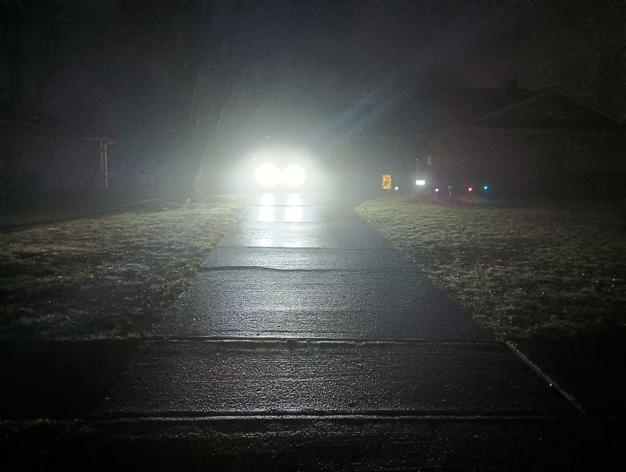

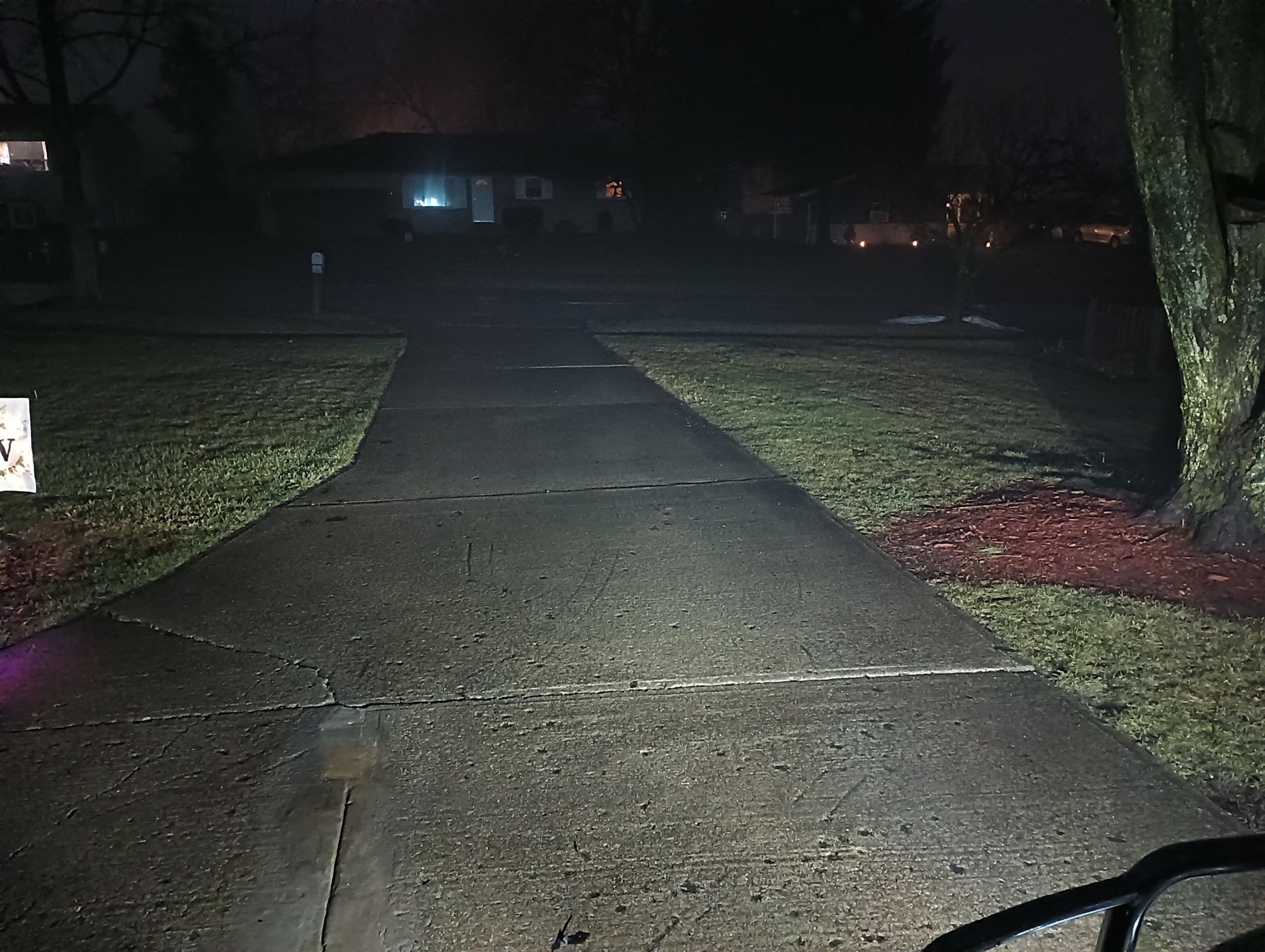

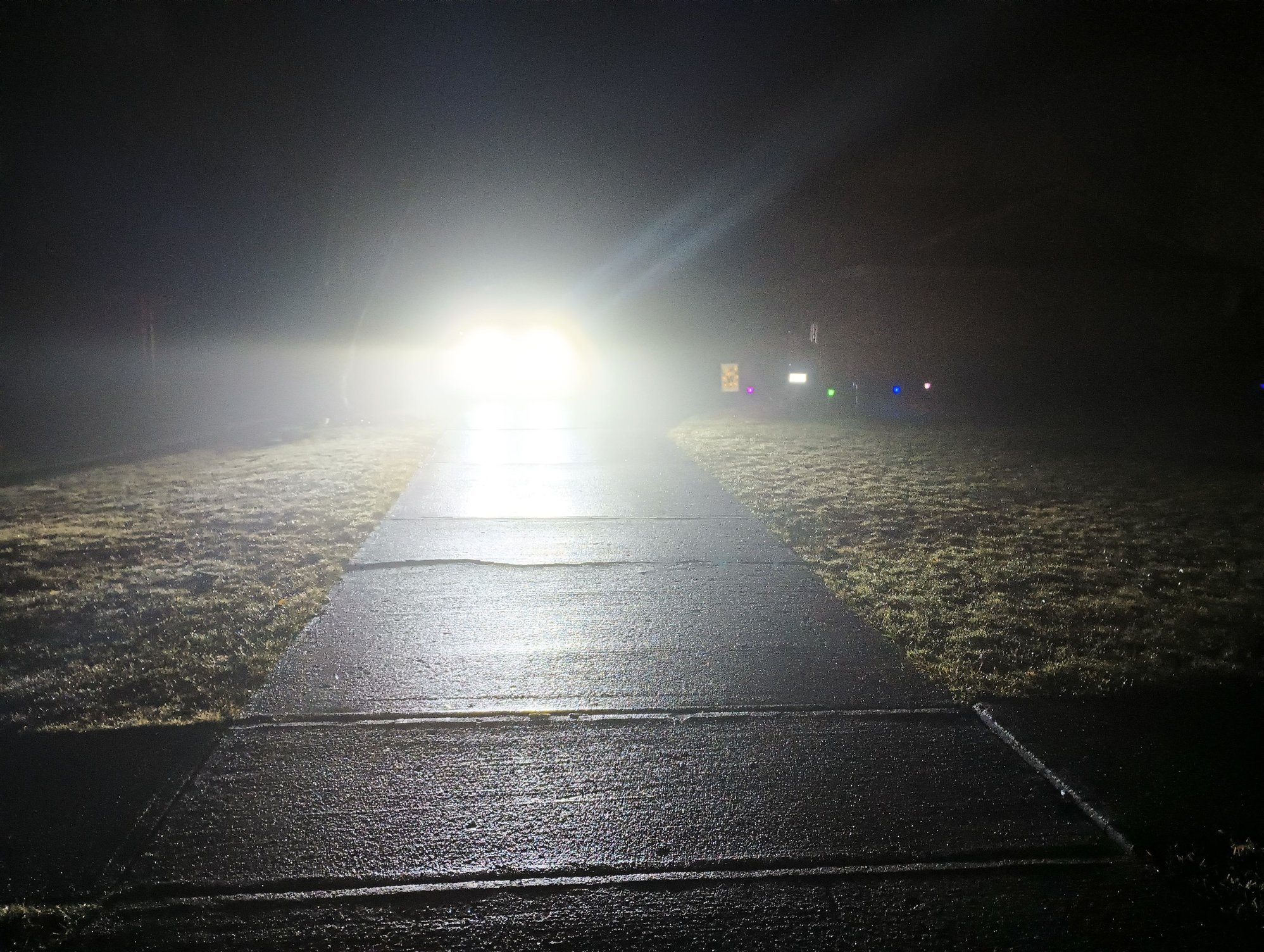

I just took pictures of the light output in my driveway at dusk,foggy night, and my driveway has a positive grade. Fogs front and rear and fogs with headlights front and rear. My 3 is pointing at the house across the road(approx 150ft away) and the light is weak drivers side(prevents blinding oncoming traffic) yet you can see the light beam drivers side points UP, not at the garage door pointed at,yet light beam show on the right. The oem enclosures work with these led's and I've never adjusted them:
fogs from the rear:
fogs+headlight from the rear:
fogs front at 60ft(note light beam ds upwards & ps down):
fogs & headlights front at 60ft(note light beam ds upwards & ps down):
