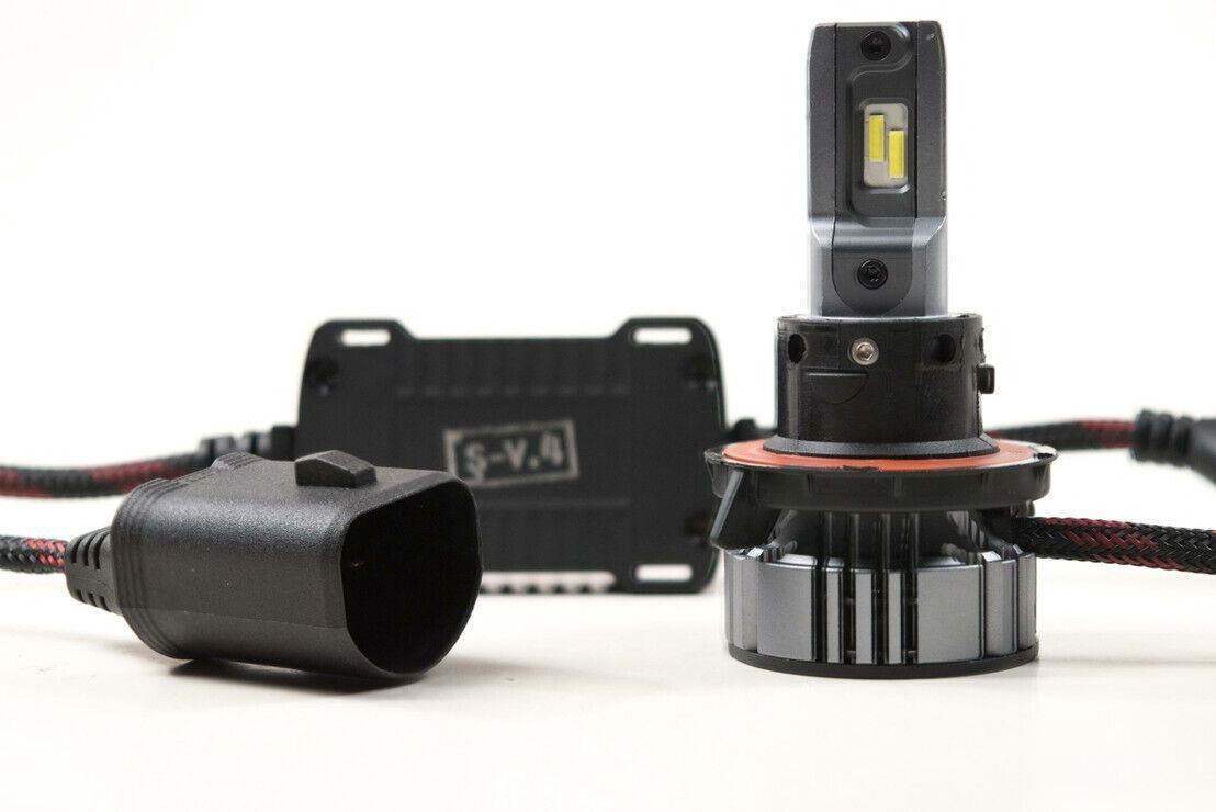

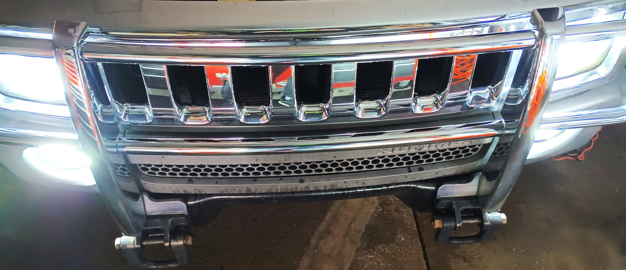

My 09 H3 Alpha came with headlights. I used LED bulbs for headlights and the fogs....... called them done. No adapters needed, just a simple re-adjustment.
Of course, that was long after the important stuff like Rock Rails, UCP, winch bumper, exhaust, intake, PP TB, tires, Cam and LS6 springs, HP Tuners, Efan conversion, speaker and sub upgrades with Dynamat and Alpine Stereo....
Old Jan 24, 2024 | 01:59 PM
100+%
My amazon vine account sent me a set of>
H13(9008) & H10(9140/9145) 6000K H13(9008) & H10(9140/9145) 6000K
to test at no charge. This gave me a chance to compare my sylvania ultra super special secret sauce gas halogens. These leds are plug and play, and I did 1 bulb at a time and compared hl and fogs. A HUGE difference in brightness, perfect WHITE, and plenty light.
