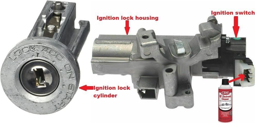

If you suspect the clutch safety switch, disconnect it and clean both the switch and harness side connection with CRC electronics cleaner. Do the same thing with your ignition switch. The CRC E Cleaner should be standard garage equipment for anybody with vehicle/equipment more than a few years old.
Photo below courtesy of hummerz.

also doc didnt get to try to clean the contacts on the ignition housing like you said, because I wasnt sure where to start? Is it just the two screws on the plastic underneath and then I can disconnect a plug and spray? or do I need to pull the whole thing out and disassemble? The key barrel itself doesnt seem bad, I dont feel any resistance or binding when I try to turn it. is that also a spray of crc down into the barrel then insert the key and jiggle?, or is that a wd 40 job?

The ignition switch is a to screw and do. Scale of 1-10, 10 being most complicated with special tools, about a 1.5. There are vids posted here an on the web for the "H3 Hummer Ignition Switch".
Take a look at this thread........... Ignition Problems

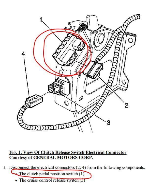

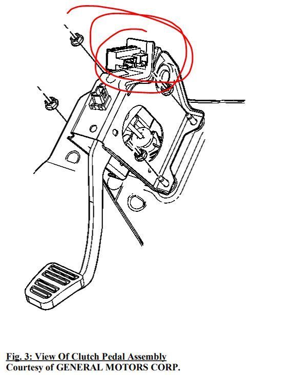

Sounds like the neutral safety switch on the clutch pedal bracket.
Follow the clutch pedal up under the dash.
Look @ the pix below. I would first wiggle the wires and see if it will start while wiggling.
Clutch Pedal Position Switch - GM (15101582)

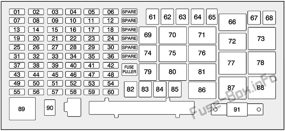

That was easy and should always be the first thing to do when checking for a failed circuit.
GO TO THE UHFB & CHECK FUSES /RELAYS!
If you researched this site you would have seen numerous posts from me advising to SWAP RELAYS to check results. In your case simply swapping #78 with #88 would have solved your issue. Hope your a$$ doesn't hurt. Live & Learn.
