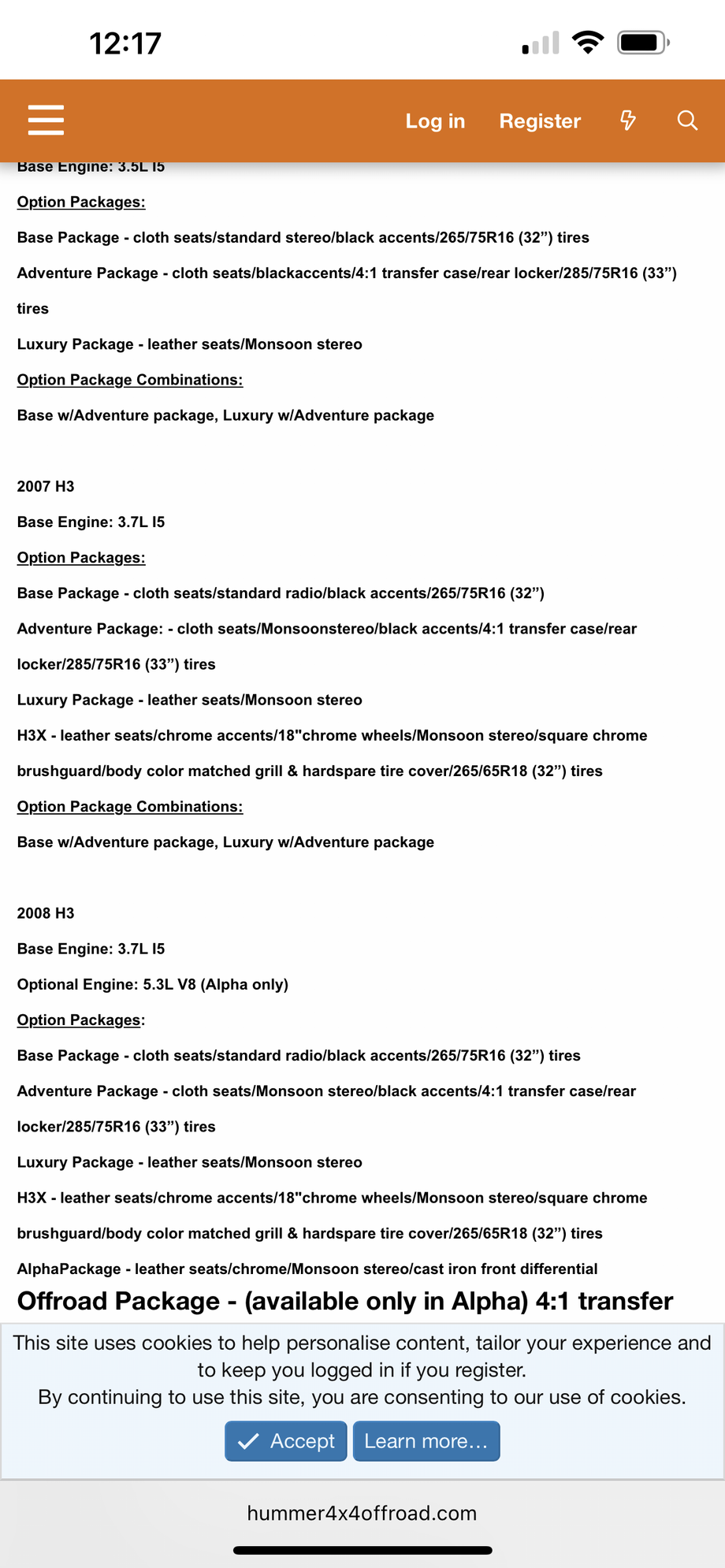

I recently purchased a 2007 H3 and I’m curious about the package/trim info. I’ve been through tons of threads explaining this but mine appears to have things from different packages. I found this explanation on a thread.
but mine has body color grille, black brush guard , black accents, chrome rims, sticker for 285/75/16 tires and no buttons for locking diff. Maybe it was modified by previous owner or what package could it be? Thanks

The 285/75-16 tire sticker shows that is has the Adventure Pkg, but a previous owner must have changed out the locking diff button.

The RPO code for locking rear differential is G94. Look on the label in the glove box from Hummerz picture to see the codes specific to your truck.

You nailed it:
G94 AXLE RR ELECTRONIC LOCKING DIFFERENTIAL, DRIVER SELECT
Also, make sure the glove box label vin matches the other vin labels & title.
