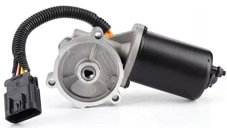

Hey guys. I have a 2007 H3 hummer I just replaced the transfer case plastic to metal shift forks, the range fork and shift rod inside the tcase. After putting the tcase back on and then the encoder motor and battery, the hummer is now in limp mode. It’s also stuck in 4HI and won’t go into 4HI lock or 4LO. Any suggestions of where to start troubleshooting this? Do you guys think it’s the encoder motor that now needs replaced or is it something like I need to fry out the ecm or clean the TB or something. Any and all sugg appreciated. Thanks!

This unfortunately was not a basic shift fork replacement. There was extensive damage done by a body shop that didn’t know what they were doing when putting on an encoder motor for me and broke several parts inside the tcase. However, we went through it with a fine tooth comb and replaced whatever needed replacing. All the gears were obviously lined up and we made sure everything worked properly inside the tcase before even putting it back on the hummer. This is the first time the hummer has gone into gear since it originally broke down a while ago. It took us a ton of work and time and money which is why it’s been a while but now it just goes into limp mode when turned on. I never replaced the encoder motor again after the shop replaced it and I’m wondering if bc they put the encoder motor on when it wasn’t the encoder motor and it was the shift fork if the tcase destroyed that encoder motor that’s on it even though it was a new encoder motor bc the shift fork issue hadn’t been rectified yet….

To diagnose the shift encoder motor remove from Tcase, leave plugged in and see if it will change position.
If it works, then your issue is the Tcase internals.

The encoder motor just turns a square peg to the degree you select with the dash T Case buttons. You could try a new one if you want, but I would test the current one and its harness connector. Easy stuff first.

ONLY 1 Way to install the encoder motor!
"Limp mode" would not be caused by a transfer case error, stab sys on the dash could cause it.

You may need a better scanner that will read ABS fault codes.
Every time I have seen STABSYS faults it has been ABS related. With an ABS related fault you are not able to switch Tcase modes unless you do it manually.
