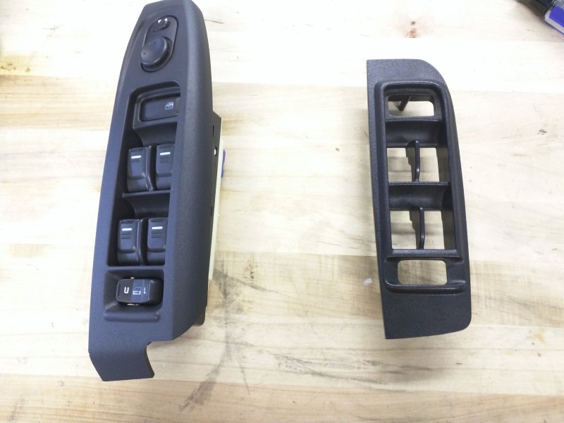

For the driver side, I needed to purchase a new bezel to hold the switches. The GM part number was 25876084.
The window switches are unchanged between the years, only the bezel is different. Here's a picture of them installed in the new bezel.
