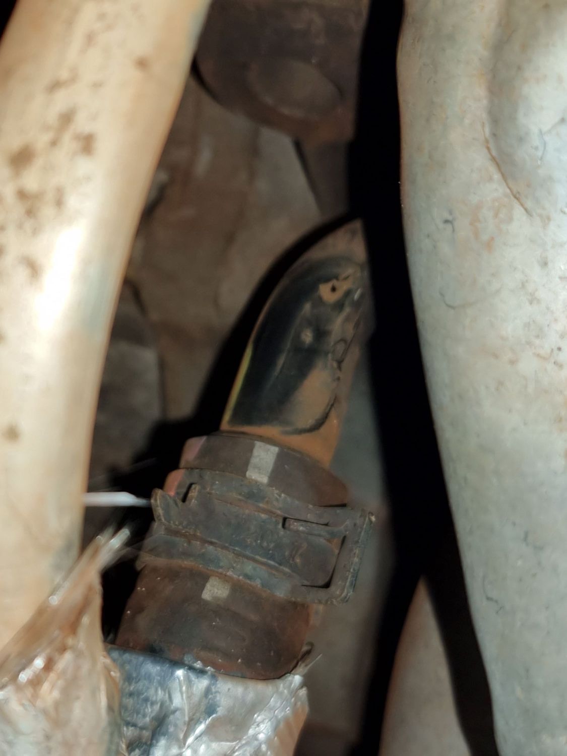

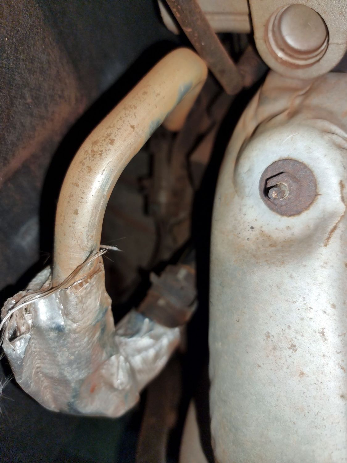

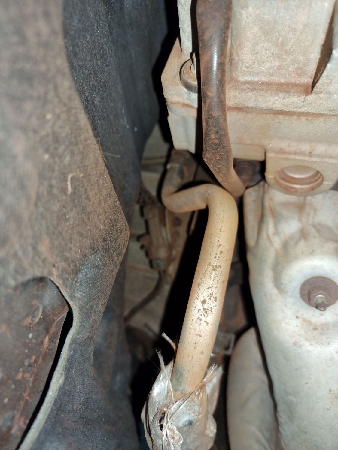

Hi all, if its OK I'd like to ask a question about a pipe leak I have found in my H3 3.7. As per the picture Ive found a hole in a pipe in possibly the worst place you could ge one. It appears to be a pipe to the heater or similar. Where would I find a replacement and I don't suppose anyone would have a suggestion on how to go about changing this part?
thanks

Sorry, did I put this in the wrong place? Yea, its the pipe the heater hoses are connected to that appears to have the hole.

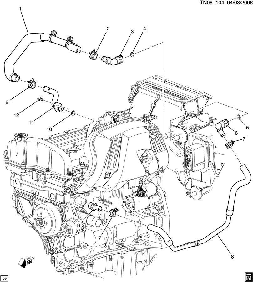

MOVED to the H3 section where all H3 questions go. Are you talking about #11 below? PIPE. Heater = Part Number: 12564053 Supersession(s): 12624499 which is no longer available. Might be tough to find one. You may have to remove it, repair it like through a radiator repair business, then reinstall?

Hmm, perhaps I could replace the whole section with a new flexable pipe?

I think its differen
t from the diagram due to being a right hand drive, I'll need to try and trace the pipes that dissappear around the back of the engine.
